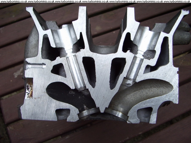

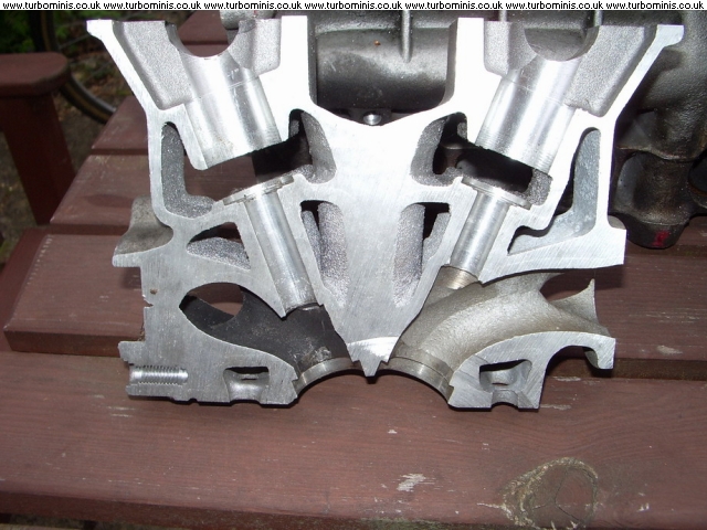

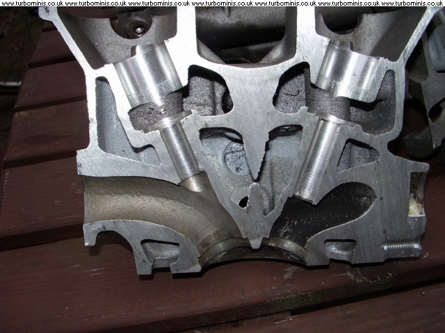

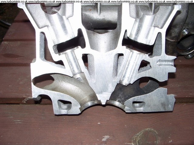

A few sections through a ccylinder head of a K1200RS (one cylinders worth)
- cue one of the major reasons for the head flowing like it does - the very nice and long short turn radius on the inlet side - if you ar eporting your own head be careful in this area.
As you can see there is plenty of meat to work with in the walls and a nice thick deck.

thanks for this John, you can see why the heads seem to run so cool looking at the water ways.
Nice one!!
as you say, the inlet is a nice shape, for a std port, little bit of a change on the short side of the exhaust but still pretty good.
John do you know if the 1200 casting is any different to the 1100 one or it it just machining differences?

the casting is different to the 1100 ones only i nthat it is a new casting tool - probably changed for the 1200 intorduction. The 1200 heads have the cast in bump for the vertical oil feed to the heads - but not the drilling, on these engines the oil is fed into the cam gallery via the chain cover - slightly odd if you ask me! also the 1200 has extra fixings on the head for the chain cover - with respect to keeping it in contact to ensure pressure isn't lost - ref oil feed hole!!! this doesn't alter the conversion parts in any way.
Jim - yes all that water plus ally = nice cooling!

so waterways etc are the same between the 1100 and 1200.

yes the waterways etc are the same - good old bmw not changing anything without cause!

drats, doesnt really look like theres much area to cut away for lowering the compression ratio :(

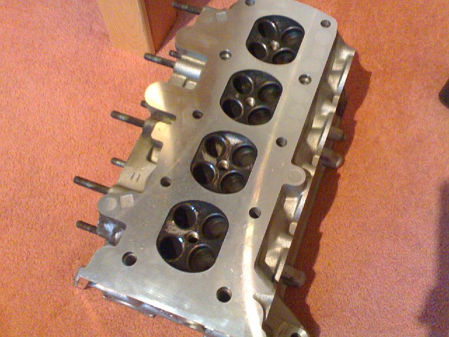

Something like this...?
Is that your head Jim?
yes matty
Jimster, what i meant was, adding an extra 2mm to the deck, rather than just dry decking *wink*
LOL, you would have to be carefull not to warp the head
Jim thats pretty impressive,
make mw wonder if it would be possible/practical/easier to to weld on a 3-4mm thick plate on instead.
