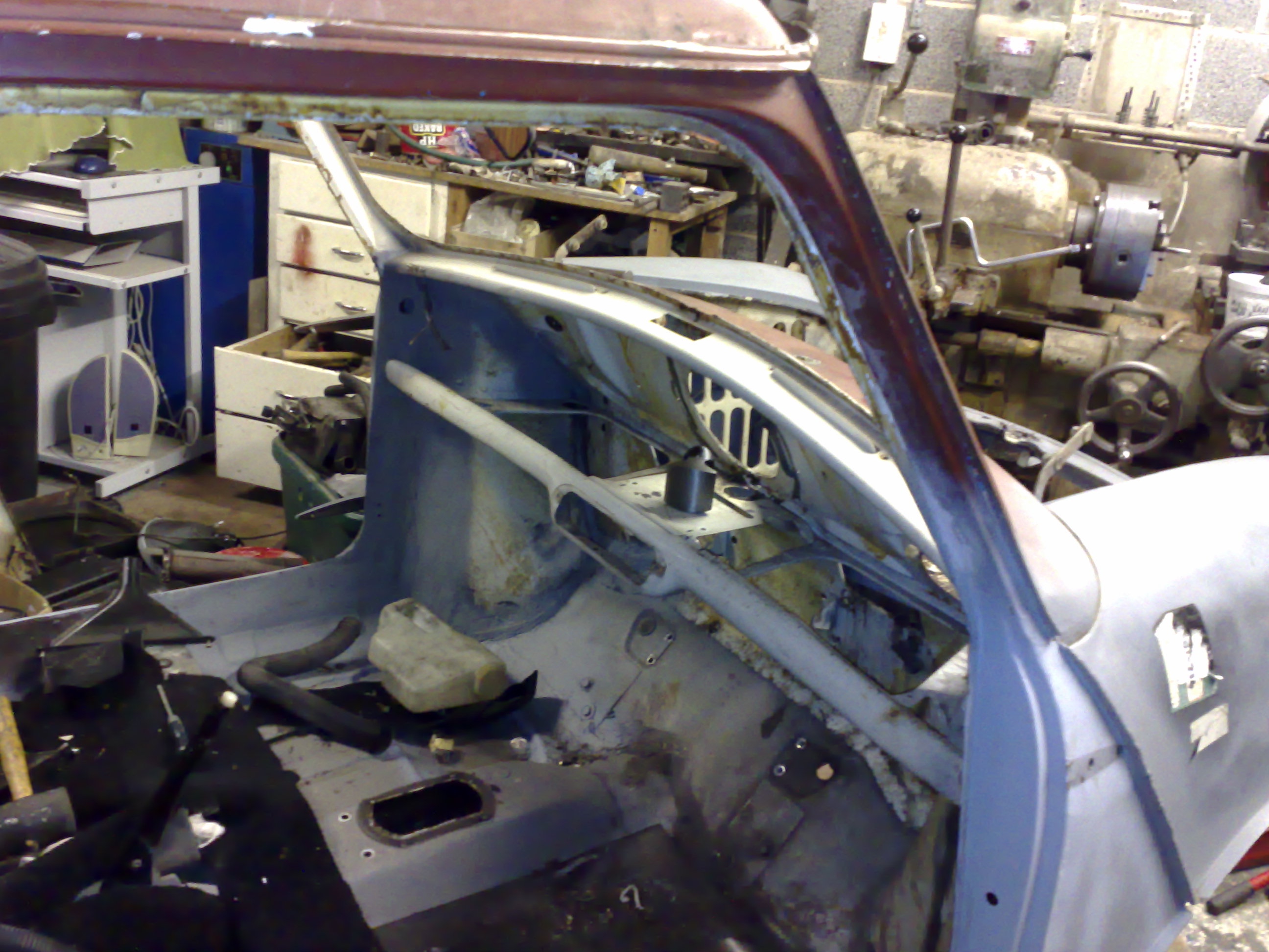

i'm tyring to get all my research done before i start putting things back together and realising it doesn't work, i'm gonna make a custom steel dash with all my gauges in hopefully, i've got a load of 2" smiths gauges to go in as well.
1976 mini van soon to be turbo'd (it doesn't have an engine at all at the moment)
