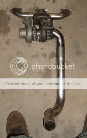

manifold , turbo and down pipe (off the car-obviously)

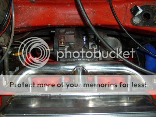

manifold on car, theres a fingers gap between the turbo and bulkhead! but a longer engine steady has sorted this, get busy with the welder, or by an adjustable one from minispares

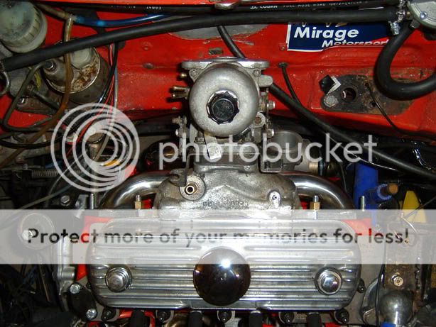

manifold on with the carb, it fits in with the standard mg metro inlet

Did the downpipe clear the pot joint ok ? it's hard against it on my Mirage kit ....

The turbo (mirage T2H1) is a hybrid. Uses a a different trim compressor wheel and reprofiled T2 compressor housing. Also has a 360 deg thrust bearing.

If my thinking is correct did you get your manifolds at the start of the year ? if so did you send it back to me when i said there had been a error made on the last batch i had made??? (rectified) Just looking at your pics it looks like a previous batch. i'm surprised you are having an issue with clearance on the cv.
Send me a pic of the problem to rich@miragemotorsport.com and we'ff see whart we can sort out.

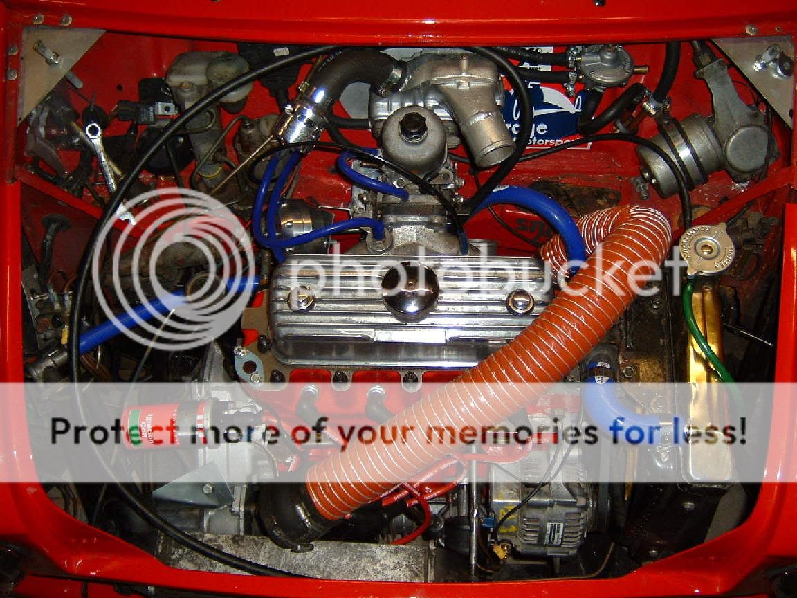

and this is my engine bay after a day of working on it, i was feeling very week as i was sick 6 times the night before, its looking very complete but isnt, still need to bolt on various pipes, do the intercooler and everything else that i cant currently remember
ass! the pictures are huge and the quality is crap, sorry
are any of those little blue hoses in the wrong place?

nic, are you sure the intercooler will work on that side of the turbo? surley it will work the wrong way?
cheers once again guys!
what do you mean by that jim? i dont get you
it looks to me that your acuator is mounted the wrong side of the turbo,
"nic, are you sure the intercooler will work on that side of the turbo? surley it will work the wrong way? "
so you meant actuator?
yeah its got to be that side so that it will fit in, mirage modded the tab thing for the wastegate so it works on that side
ahh thats good then
