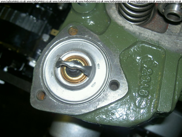

It fits in the hole ok, but seems like it's not sunk down enough. maybe i have the wrong one, or it need digging out abit in the head where it goes maybe ?

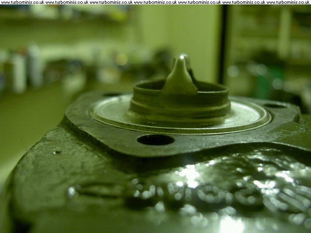

it's a metro turbo head.
Do u think it need choping out abit
As u can see it seems abit high. not sure if it's ment to be like this.
So when the housing goes ontop, it seasaw's abit. so there's alittle Gap (which u can't see in the pic) which will leak im sure.
Thats the same type housing that came off before.
What you reacon, with out slaging please *wink*
Coz i know how your mind works mr VEGARD *wink* U CANT HELP YA SELF LOL
Cheers mate
Edited by Markie_D on 4th Dec, 2007.
Shit Happen's
Thats a metro housing, are you fitting a front mount rad or do you have the special hose to go from 32mm to the 28mm on the side mount rad?
Anyway, which ever housing you use, it should still fit flush.
I dont see any problem in your picture, so not sure where you are coming from?

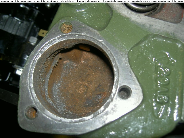

It's like the hole in the housin isn't large enough to go over the THERMOSTAT. if the THERMOSTAT sat down deeper, then think it be ok. just have to grind it out abit. as the hole on the head dont look very even at all... u cant really see to much in the pics.

The thread in the head casting is 5/16" UNC (note, UNC, not UNF).
The (earlier) Minis used studs and nuts, the studs being UNC at the head end and UNF at the nut end.
The Metros used much longer UNC bolts straight into the head but there was also a sandwich plate between the thermostat housing and the head for the heater supply pipe (hence the bolt being much longer) but your photo is without that sandwich plate.
This may have something to do with your problem in that the bits were assembled in a different order on the Metro.
Edited by Rod S on 5th Dec, 2007.
Jay#2
2500 Posts
Member #: 648
Northern Ireland (ex AUS)
Good point. The thermostat goes between the housing and sandwich plate on the metro and not on the head itself.

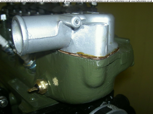

Maybe thats why then.
The old housing that came off mine,
Is the same as mine is now. ive dove what hogster and Sprocket said.
and all sorted :) just have to make the hole part on the gasket abit smaller.

A Lot of fuss over nothing. Just bolt it down *wink*
Torque setting is better at hand tight, rather than what it says in the book.
Also it looks like thats one of the minispares fibre gaskets, so keep an eye on the tightness of the bolts after a couple of trips out, the gasket tends to compress up alot after a while.
