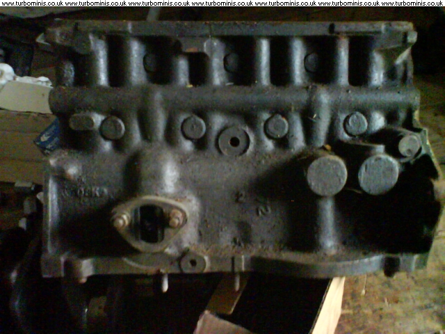

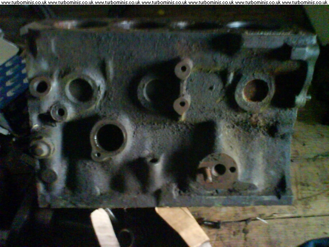

Alright guys can any tell me what this is out of?
its got 11 head studs,
and the code is 12h 298f 38457
its the distributer clamp and the extra castings on the back that threw me.
can it be used in a mini?

looks like an early a (not a+) block. i'd wait for someone to confirm this.

Looks just like my 1275 GT block

Why not? If it has not got the hole above the centre main it should be as good as any other block

No, In the block, directly above the main bearing housing. The hole is about 3cm x 2.5cm in the web between the base of cylinders 2&3 and the top of the main bearing housing.

yep,
use a head gasket to mark the hole and whack a pillar drill through it.
even if it does have the hole above the centre main bearing it might well e ok in a turbo motor as it will not be spinning to crazy rpm.
I'd just run a dremmel round the hole to get rid of the pointy bits and use it.
That deffinatley a 1275 gt block, i have 2 of those in my collection of blocks!
Well, it could be an Allegro /1300/ 1300GT block as well. Not easy to tell whether it's a 1275GT one.
Even if it's got 11 holes, you don't need that on you head. The gasket will seal if there's a hole to the waterpump. When this is said, it's easy enough to drill the two holes.
