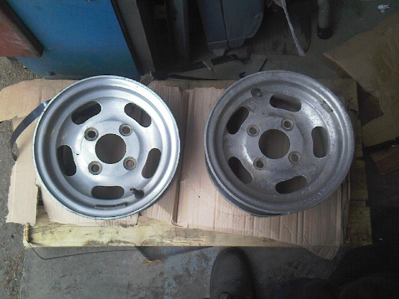

as above really.
just got them off flebay for a bargain £40 the lot *happy*
Just incase you wanted to see (and i want to show off! love them!!)

fastcarl can machine some wheels to take half a split rim, i'm fairly sure these are one that can.
yeh done a search before posting and know that there is a certain few that can be done, but i couldn't find whether these were one of the few. i emailed carl a while back which had the list of ones he can do but i cant find the email now :(

Hi Joe, its either minispecials of cobra supaslots , unlesss your particular set had enopugh meat to machine a flat into at the valve section
They look like the ones Carl did for me:

if they are cobrs supa slots then they can be done, look in the rear . the name should be cast in .
carl
ahhhhhh foooweee, nothing said on the back :( oh well still love them! clean them up spray them *happy*

thye could be later ones , no id on them but still able to be converted.

oh, any way that i would be able to tell if they can be or is it something that you would have to see?
It's all about how thick this bit of the wheel is:
From what I understand it needs as much meat a possible so that the bolts have something to hold onto (technical terminology).

thanks rob, that is a shot of an early wheel, the later ones have less material in this area but still can bw done,
