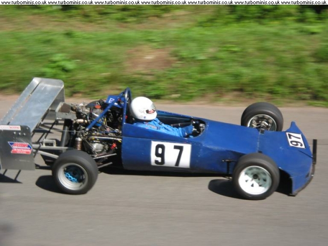

Here's a pic of the car...
Edited by mike_jenkins on 22nd Dec, 2007.
Welcome, it's good to see something a bit different :) hopefully I'll get to see you're car in action at some point (if I don't get mine finished I'll be doing some marshalling).

Cant see pic!!
