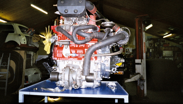

JC T ONE
69 Posts
Member #: 2974
Yes its right that the oil went back in the engine trough the petrol pump bracket on some JANSPEED A series TURBO engines, but look in the Vizard book, there is a pic where you can see a breather connected to this, on this version the oil went back trough the breather hole in the transfer gear house.
JC T ONE
69 Posts
Member #: 2974
Heres another, but if you see the Vizard book they made different setups of this, on one of the engines in the book it draines back through the clutch housing vent.
