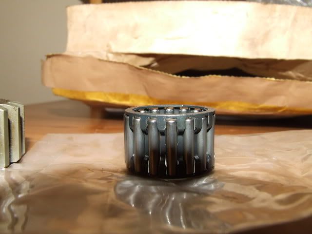

well my gear and needle bearing i paid 150 quid for from mr JKD is completely the wrong item. i specified Second gear for a straight cut metro turbo challenge set.
i dont know any different here mind so a cog and bearing came and i left them with the engineer.
spoke to percy today. needle bearing is the wrong one, and the gear is for a "dog box" ? when compared wih the original its totally different.

The needle bearing is supposed to be readily available from JKD, i know jim has had them off them easy enough.

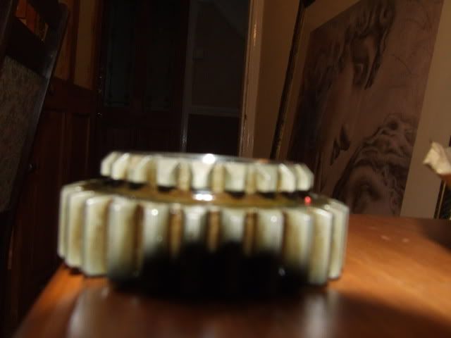

that gear you have posted a picture of is that the new gear or the old? as that gear looks like a syncho gear to me. The challenge boxes where 100% syncro. I replaced my bearings and got them from JKD
dull post, now removed
Edited by Nic on 9th Jan, 2008.
Isn't that an Involute dog gear Jim?
those dogs do look a little large for a syncro gear
you could be right, I'm comparting it to a swiftune dog kit.
Aren't they face dogs?
Richie
3184 Posts
Member #: 628
that is the new gear, and the little bits (i think which are the dogs) are massive in comparison to the one i have. Percy has built the box for me but his words were "that second gear is a concern" recons it will slip out every time i take me foot off the gas (in that gear)

pissed off with JKD big time ! they should know that the gear would be duff, and i spent ages explaining which needle bearing it was.

On 19th Jan, 2010 wil_h said:
Richie, I have a 2nd gear here (27 teeth) it is stamped JKD 52 STR943. The teeth on the main gear ar in good condition, but there is no molly left on the cones, the clutching teeth have alos had a bit of a hard life, but I'm sure these would clean up with a needle file.
What exactly is wrong with your 2nd gear?
Richie
3184 Posts
Member #: 628
i dont know i have no idea what iam looking at, Percy reckons that the gear is worn to the point that he erckons if iam in second gear and i take me foot off the gas, it will slip out of gear ? what would cause this ?

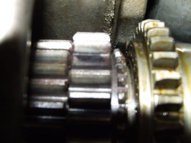

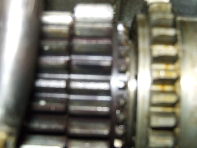

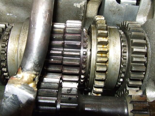

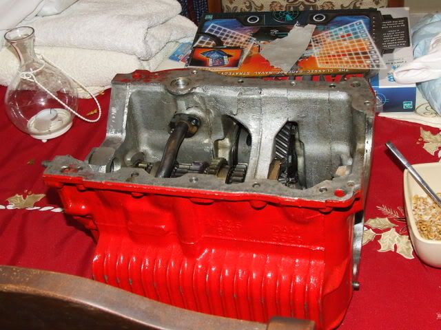

Richie
3184 Posts
Member #: 628
got some really basic pics here. cant see any numbers on the side of the gear mate coz i am a cock face i didnt note it down prior to it going into the box.
TRADER HALL OF FAME
TRADERS OF SHAME
1 user....pm me 4 details
LEGENDS
MikeRace, Mini13
On 17th Aug, 2009 Jay#2 said:
The gear I have is about the same as that to be honest. The gearkit you have there cam out of an egine which had no problems, personally I'd try it. Does you gearbox guy really know his stuff?? I'm far from an expert, but I've seen far far worse in gearbox's which have been working with any problems.
