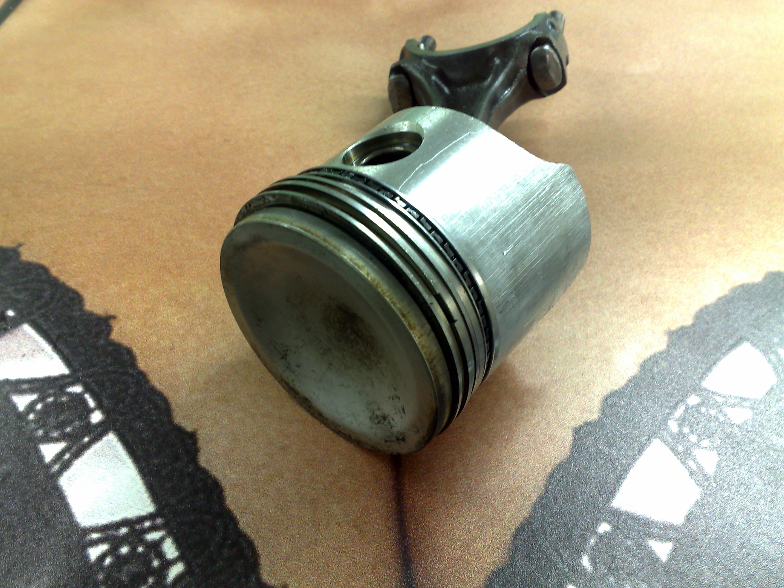

I'm rebuilding my Dads engine, I've stripped the engine down to find that it's already +020. Does anyone know what pistons these are?

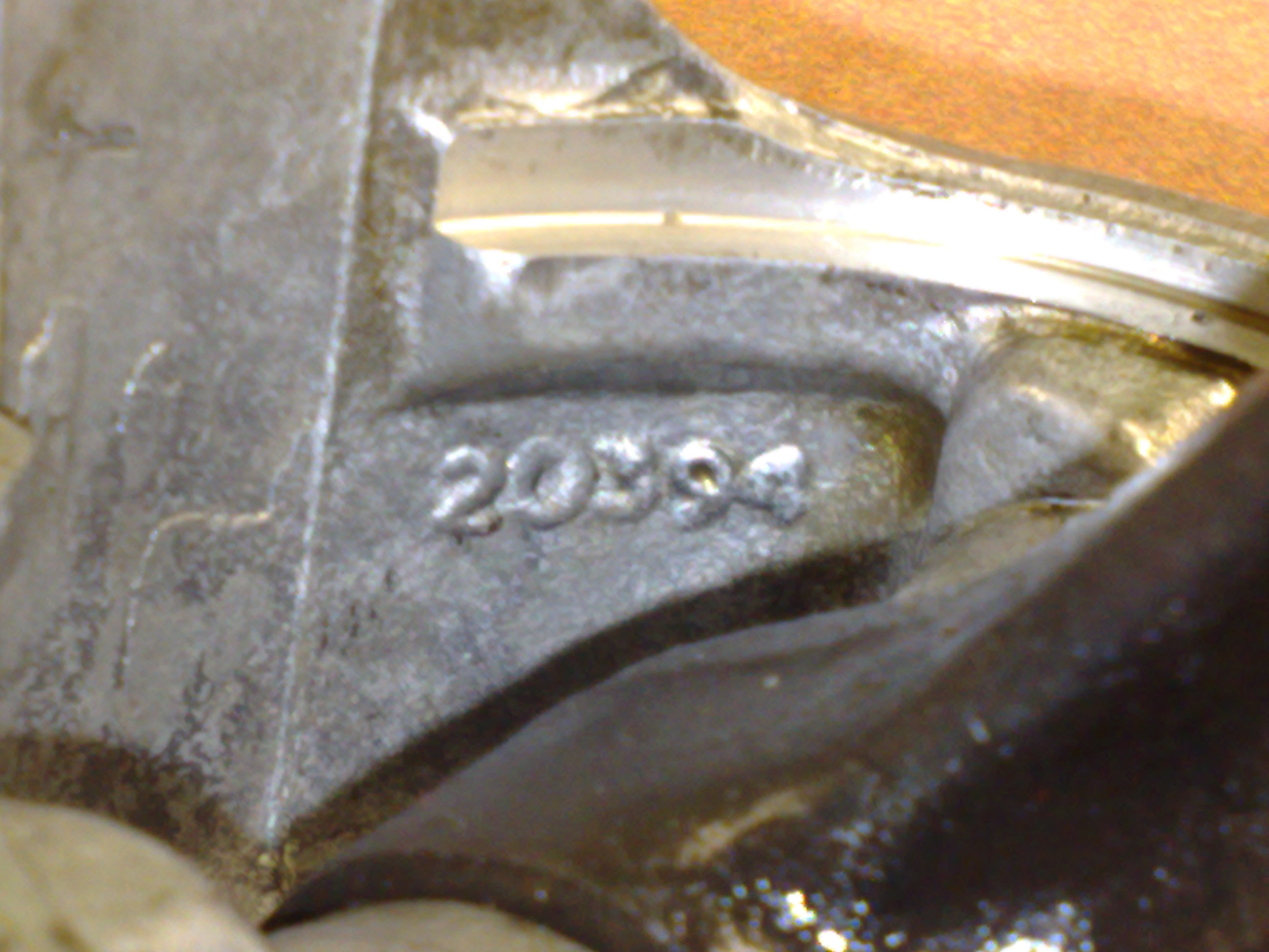

Hepolite 20394 is the piston number and 4 ring so would recon on Cooper S over size maybe

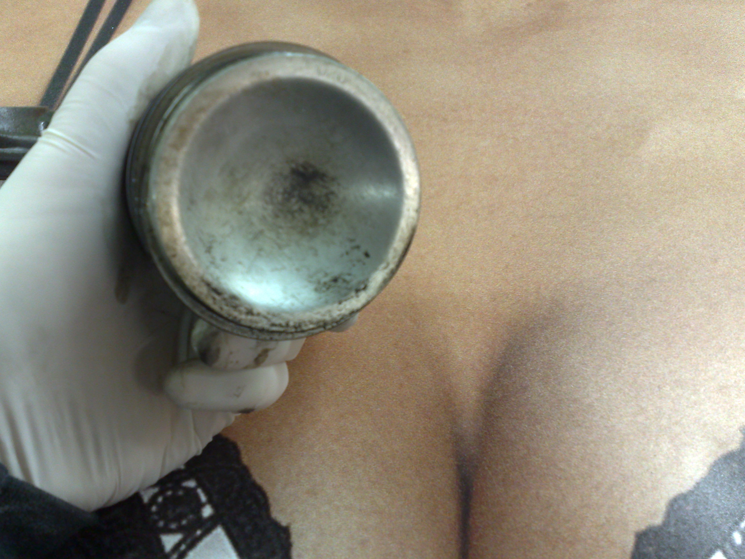

10cc dish

4 rings lol, throw them in the bin.

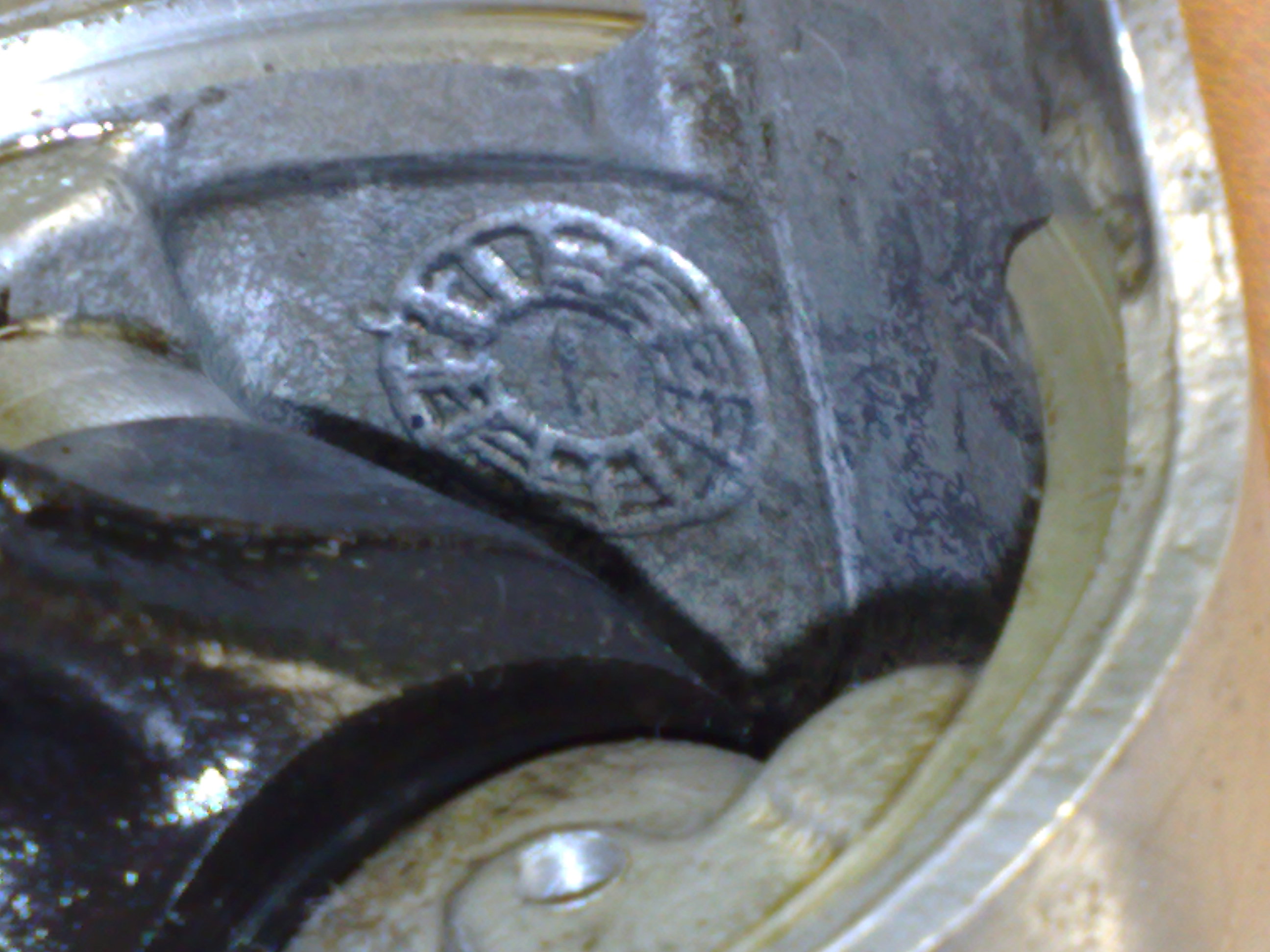

They look similar to my AE turbo pistons especially the skirts but the numbers don't match & after going into the garage it would appear that the no. of rings are wrong.
A google search says it's a 70.62mm AE piston for BMC engines.
A bit more searching seems to point to the MK 3 Midget, so pretty much the same as a coopers. I'll dig out my MG books in a minute and see what I can find. However I'm not going to pull the engine out of my midget just to see what the piston numbers are.
Bit more searching, seems to point to the Midget pistons. Vizard says "Robust engine, good for up to 7K rpm"
Edited by Rob H on 8th Feb, 2008.
I'd say they're bog standard 1275GT/Allegro pistons. Do the crowns say M2210?

Anyway, back to the pistons, all they say on top is +020
why are 4 rings bad Carl? it's only for my dads clubby estate, don't think it will ever see 5k, let alone 7k.
is there any way of checking rings for wear?
