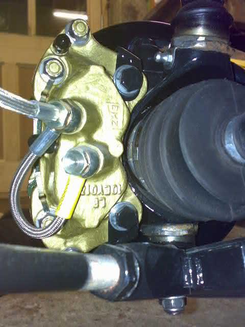

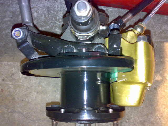

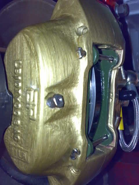

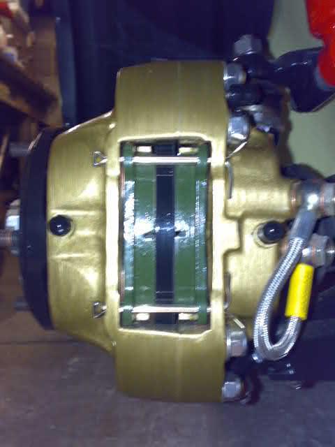

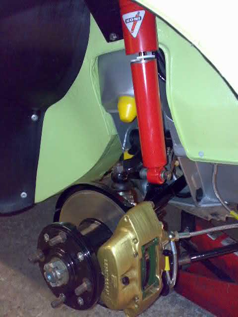

Sorry for the delay but I've managed to get some phots of the newly refurbished modded metro 4 pots as fitted under my 10 inch 'S' rims.
Just to highlight some key points if you're gonna go down this route :
- you can see the amount of material that has to be removed from the piston housing of outer caliper half and the amount of material I had to remove from the bleed screw to stop it from fouling the inside of the wheel rim.
- you should just also be able to make out the amount of material removed from the inside of the inboard caliper half to a) reposition the caliper bolt holes so that the caliper assembly physically moves in closer to the centreline of the hub and to b) get the caliper bolts to fit (this needs some of the casting of the inboard piston housing to be relieved so that the hex on the bolt clears the housing - an alternative is to use socket cap Allen bolts but these MUST be high tensile strength, not the dinky toy crap that you can also get). I retained the original bolts and only needed 5-6 mm washers between the hub and caliper in order to centralise the disc in the centre of the caliper so that each piston was protruding equal amounts.
- you'll also need to gtind off some of the material on the 'ears' of the caliper bolt holes on the hub as this means this gives a little more clearance. you only need 1-2 mm off.
Apart from the use of a Metro hose conversion set, stainless pistons, new seals and new inner caliper port seals, that's pretty much all that's needed, apart from some small mods to the disc shield to clear the new caliper and to the brake pads which need the bottom corners just ground off. You dont even really need shields, particularly if your running vented discs.
Make sure you or a reputable workshop feel competant to do this as you dont want to break into any piston porting or hydraulic chambers. Even better if you can perform a hydraulic oil pressure test before fitting.
Good luck.
Richard.
