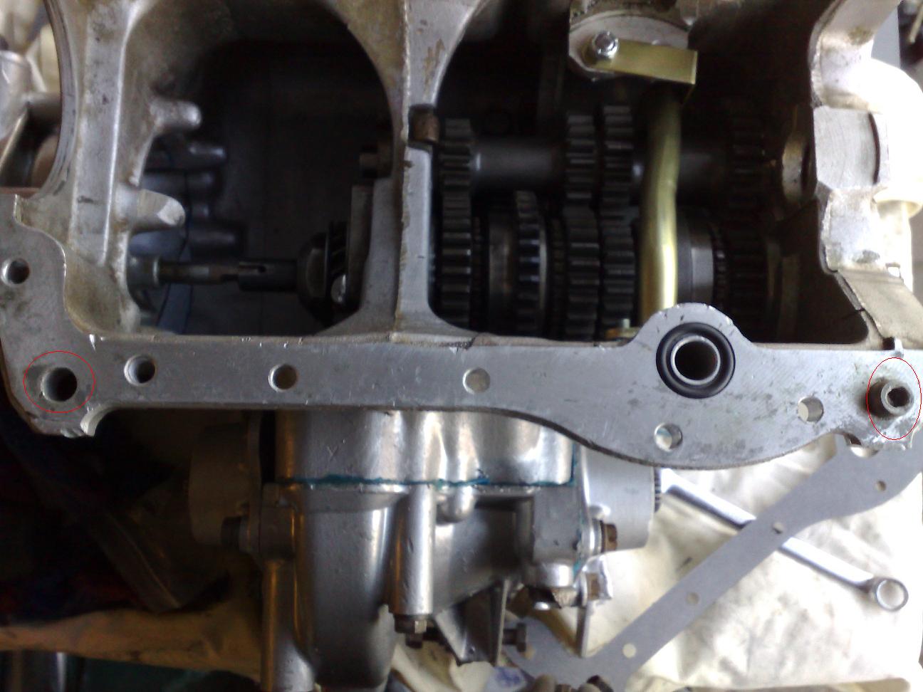

Hey, i am missing one of the dowels for gearbox - engine, do you reckon i would ok without it because i cant seem to find anyone who sells them anymore, seems like they are end of production. Or do you think i should have ago at making something up?
Picture shows the dowels i am on about, if the attachment works.

Give the one youve got to a local machine shop and they should be able to knock one up for ya.
Bout 5-10 mins if that to make

Engine-box alignment would be fairly critical, seeing as there are drop gears involved.
