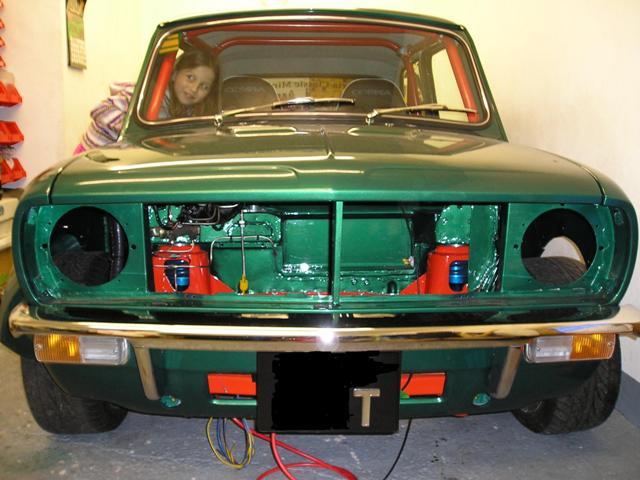

2nd Mar, 2008 at 02:20:50pm
Dont know if this will work but here goes. Edited by turbogt on 4th Mar, 2008. |

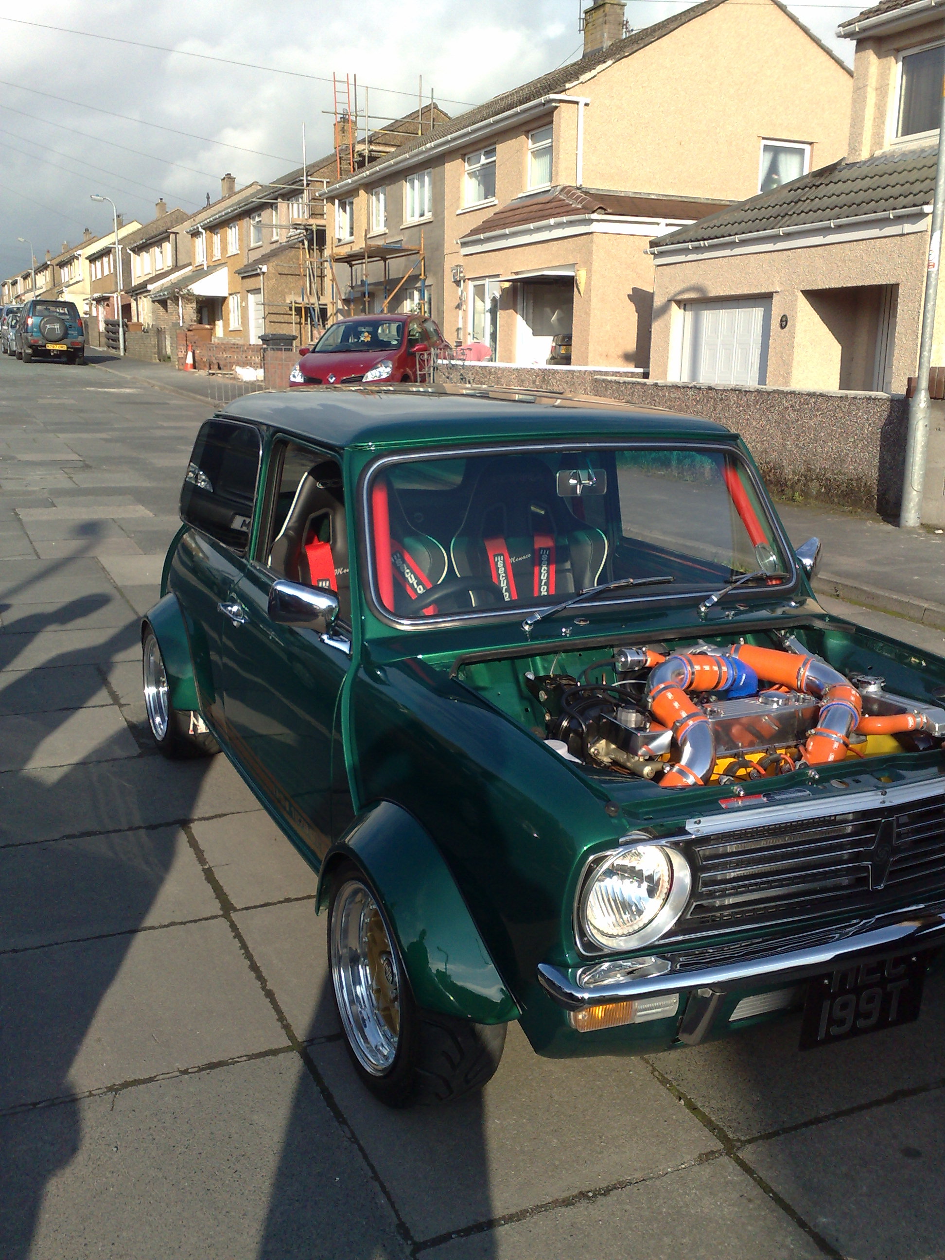

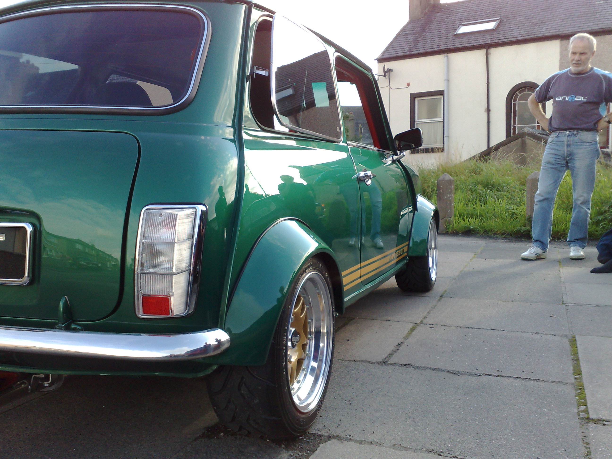

Nice car mate!! Are they miglias? |

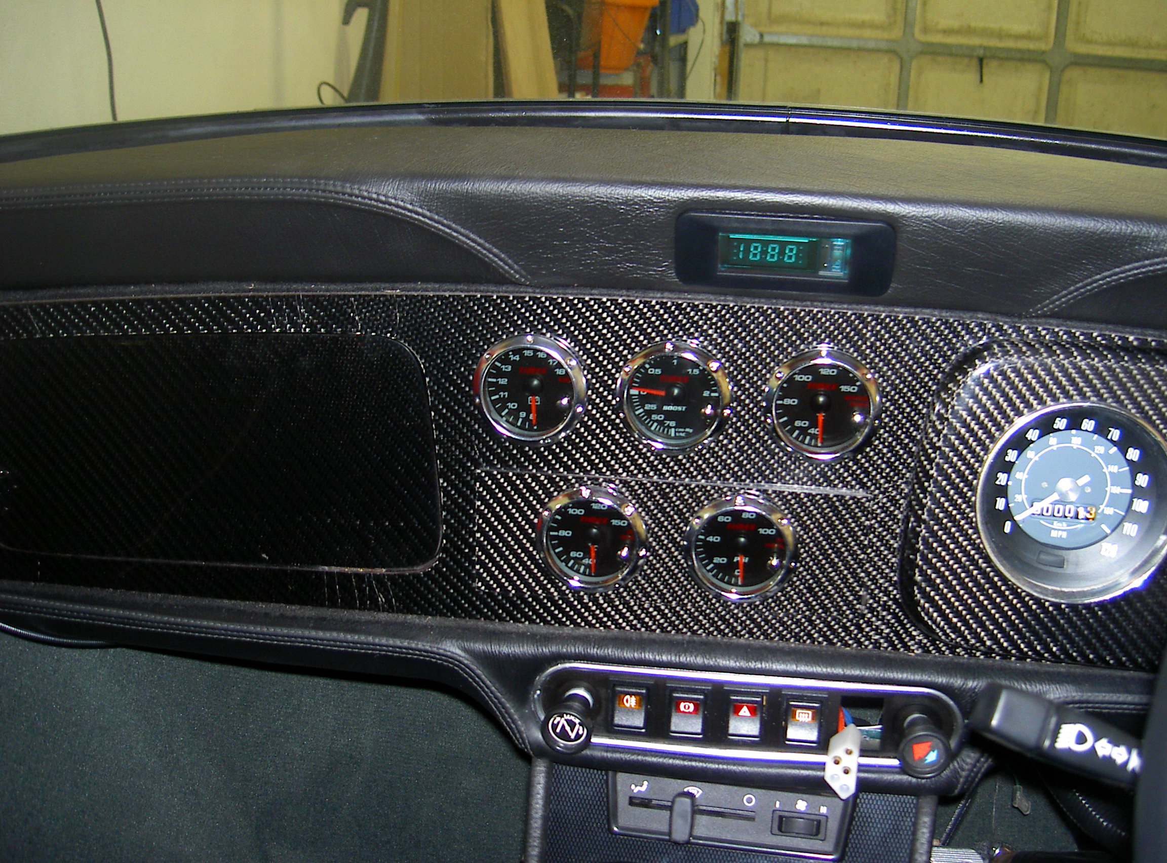

Hi mate not normal a fan of green cars but that looks mint. also loving the dash very nicely done.

Great car! but agree with Steve, ditch the square plates. |

Very nice mate, Whats going in it ? (turbo obviously)

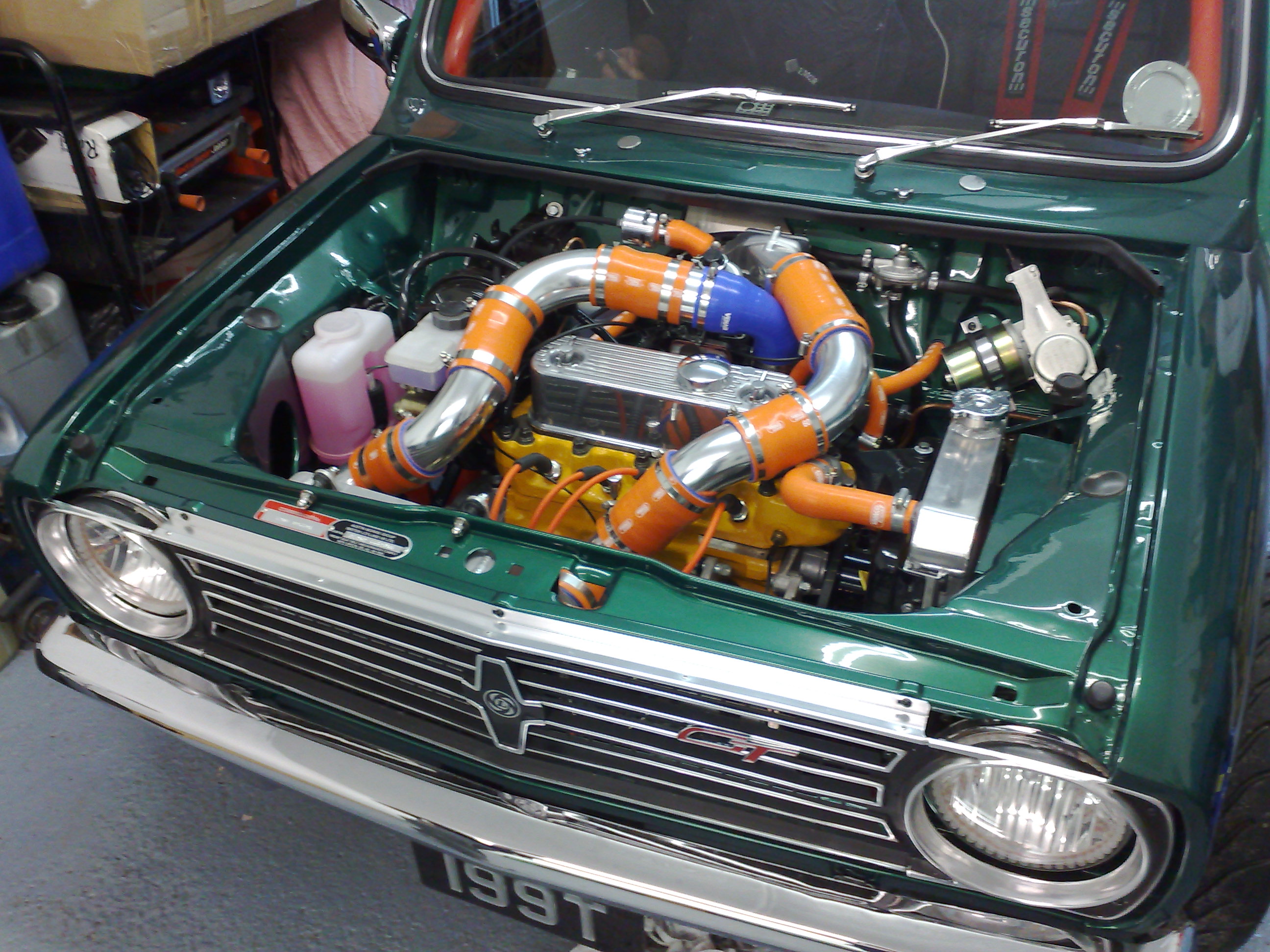

Very nice mate, Whats going in it ? (turbo obviously) Rick 1293 avonbar built engine with jkd 6 speed box. all i can tell you from his intro thread. hopefully he can give us more specifics?? great looking car mate, absolutely love clubbies!!!! |
103 Posts Member #: 2314 Advanced Member cumbria |
2nd Mar, 2008 at 10:57:31pm
The arches are miglia. It has avonbar phase 2 cam, stage 4 cylinder head, omega forged 18cc pistons, vernier timing gears, lightend and ballanced flywheel and full bottom end ballanced and avonbar turbo dizzy. its running on a jkd 6 speed dog box which i bought for it ages ago and straight cut drops, 4 pin diff. The turbo is the t3 with the different ratio on the waste gate. Im looking at running approx 12psi when its all run in. It also has tarrox 6 pots as i like to be able to stop:) |

The arches are miglia. It has avonbar phase 2 cam, stage 4 cylinder head, omega forged 18cc pistons, vernier timing gears, lightend and ballanced flywheel and full bottom end ballanced and avonbar turbo dizzy. its running on a jkd 6 speed dog box which i bought for it ages ago and straight cut drops, 4 pin diff. The turbo is the t3 with the different ratio on the waste gate. Im looking at running approx 12psi when its all run in. It also has tarrox 6 pots as i like to be able to stop:) Sounds good! What compression ratio do you have? |

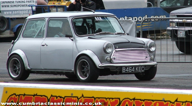

To be honest i dont know the compression ratio. Something i never asked about when i picked the spec. Yeah phil probably knows me from the shows but didnt know i was into the turbo minis. Whos the guy who sometimes comes to the shows with phill in the silver mini turbo with turbo mounted over the flywheel housing? ive seen him a few times but dont know his name. |
![]() 4638 Posts Member #: 20 My sister is so fit I won't show anyone her picture Lake District |
3rd Mar, 2008 at 07:25:37pm
That'd be Mike. :) |

yeah thats the one. I remember him fitting a driveshaft to it at mitp last year then takin it back down the drag strip. |

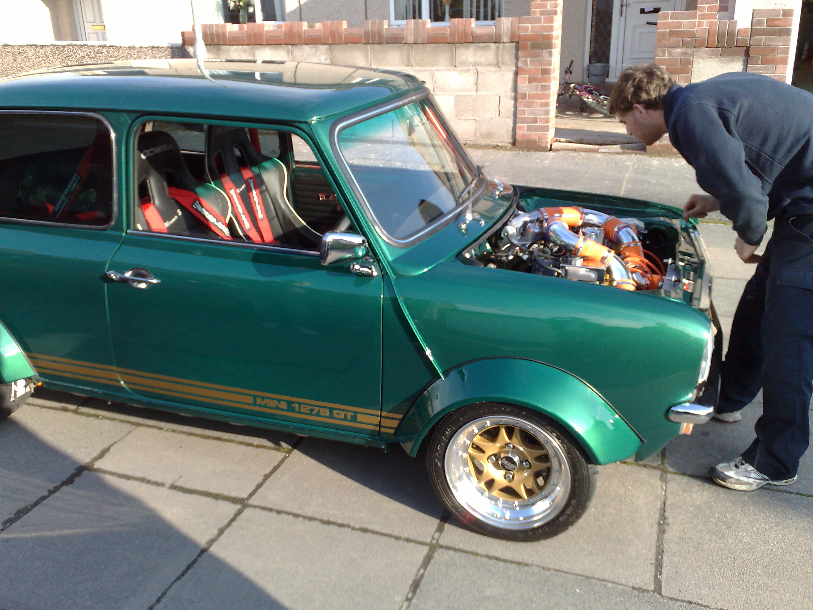

20th Aug, 2008 at 12:06:20am

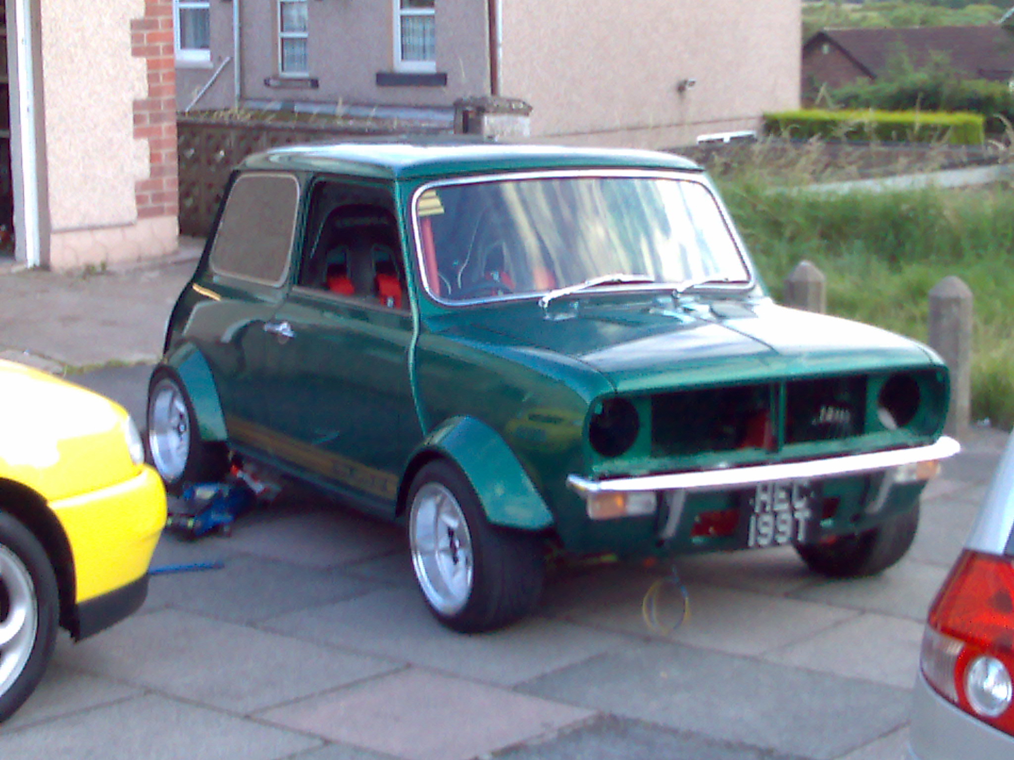

Heres a few photos taken tonite after its first start up. |
![]() 862 Posts Member #: 1660 Formally Mini_Uk London |
20th Aug, 2008 at 12:54:37am
That is different :) Very nice car you Got there mate. what colour green is That. Love the wheels. Shit Happen's |
