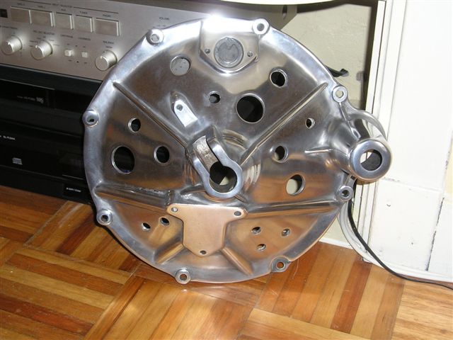

hi,
the cover of the clutch i'm already got polished:) , some clear coat over it and that will be fine.
But with the transfer casing i don't know what do do.
It has been coroded due the salt over the years.
Is it a option to get it carefully blasted or is it more like bring on the sanding paper en working mine ass off.
What did you do and what was the end result????
Regards Paneermeel

I'm going to sandblast mine then paint it with the old alloy wheel paint. might stay on...

Blast and paint will work ok. Wont last for ever tho.
But you can say the same for most stuff relly
frost.co.uk do some stuff called ally clean
made my gearbox come up like new

my first choice would be go for the bling bling. but it does not have to be 100%
i don't know what the end result would be if i had it carefully blasted so the surface is smoother than it is now.
How will the alu hold after such a treatment????
this is how my cover looks like:
