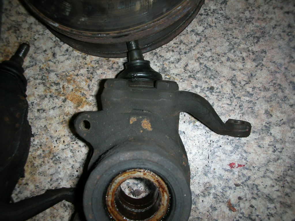

Mini or Metro?
Jordan
1913 Posts
Member #: 1392
Pointless Post Whore
Liverpool, North west
Metro by the looks of it id say. Ball joints are differant arent they?
Yes Metro.

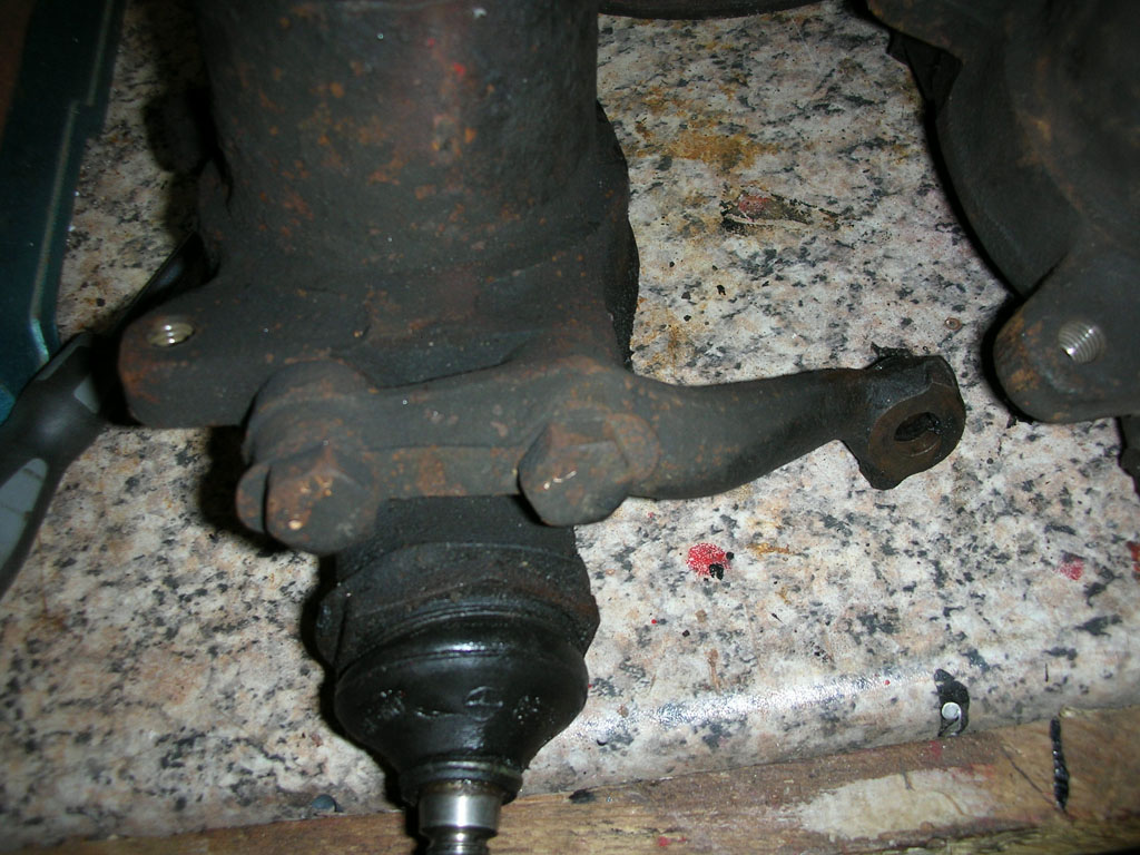

I think he asked about the steering arms? are they not mini?
Yes, I'm just talking about the steering arms. I know that the hubs are Metro ones.
Anyone?
Hmmm,
hard to say, I don't remember metty arms having the little "ears" where the TRE fits, but i could be wrong. on the other hand i remember mini ones being less "sweeping" than those
can you whip one of and compare it against one on another car?
the difference should be obvious then.
Hang on!
I'm sure theyre mini arms,
if you look at these you can see the difference in length (unless its just me!) the ebay ones are longer.
http://cgi.ebay.co.uk/austin-mini-mg-metro...bayphotohosting
I think that you are right Joe!
I will hold one up to my sisters car to see if there is a difference.
Cheers Guys
