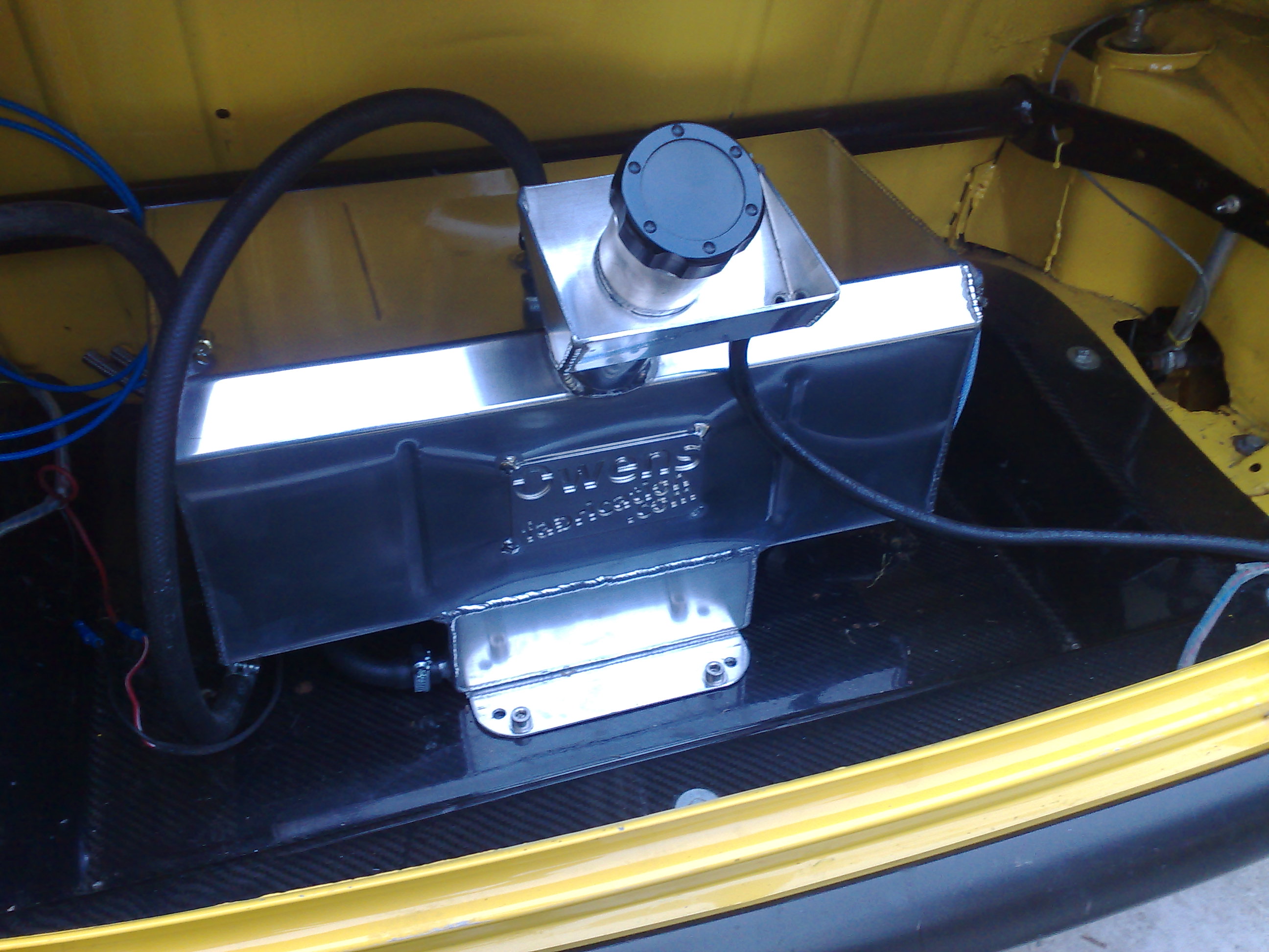

Endaf from Owens fabrication (growling sheep on this forum) made mine, built in fuel pump and filter mounts on it too (underneath).
After going EFI I did have fuel starfation problems, all sorted now

Jim, how's the pump mounted?
I'm interested in that sort of setup myself to be honest, i want a low point in my tank as hard corners, even when fairly full have caused me the odd misfire.

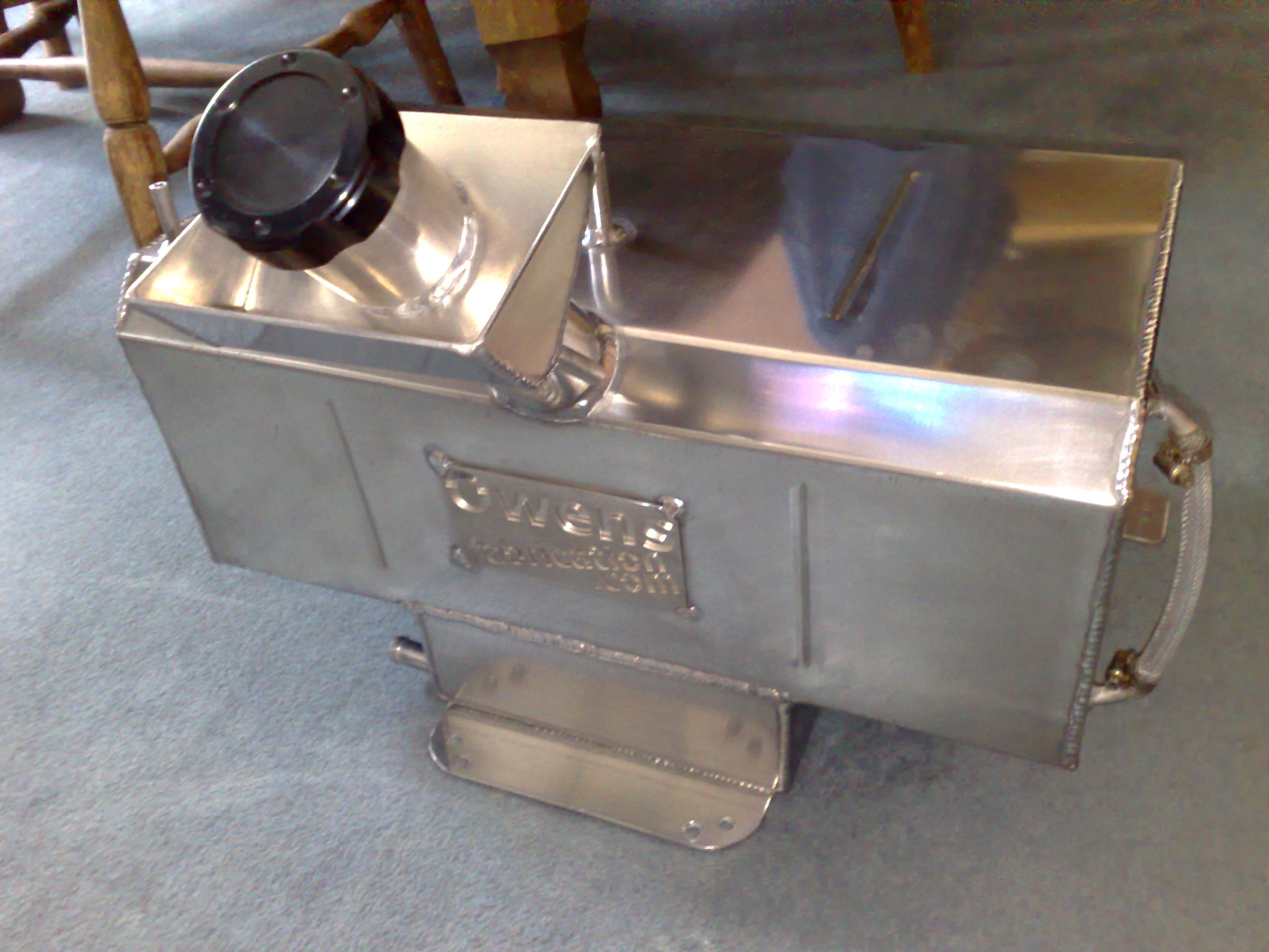

Search user alloy-racing-fab on ebay, this who made mine for me.

It's hard to explain how the pump is mounted, there is like a U shaped alloy plate on the base of the fuel tank, the pump fits in the middle of the U and is held in place with large cable ties. I'm removing the tank tomorrow, I'll take some more pics. I can't remember the size of the tank to be honest. I did work it out, I'll have to dig out the drawing, the tank is larger than it looks, it gets deeper after it has dropped down behind the antiroll bar.
if anyone else wants one of these tanks www.owensfabrication.com
heres mine:
It fits in the spare wheel and theres a little sump poking through the boot floor

Thats a cool design nic, where did you get that one ?

Iain, this is how my fuel pump and filter is mounted on the bottom of the tank

I got the tank from concept racing, they made it up-01432 850 889
Give them a ring if your interested and have a chat, bob is a really good guy
