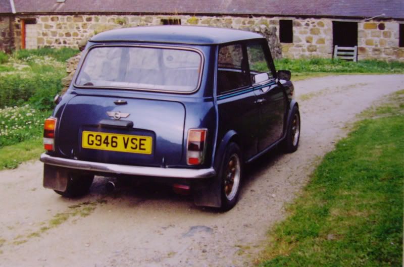

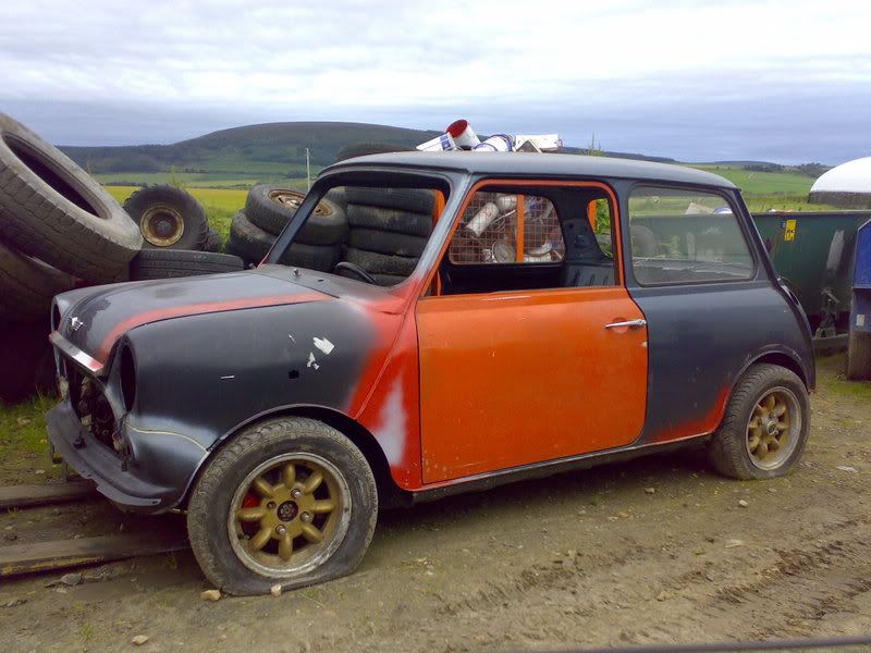

Anyway heres my project. it was my first car 3 years ago, a 998 city E but i ran it into the ground, stuck it in the shed and bought my BM. Been rebuilding it for the past 3 years and its starting to get there.
Here it is when it was on the road.

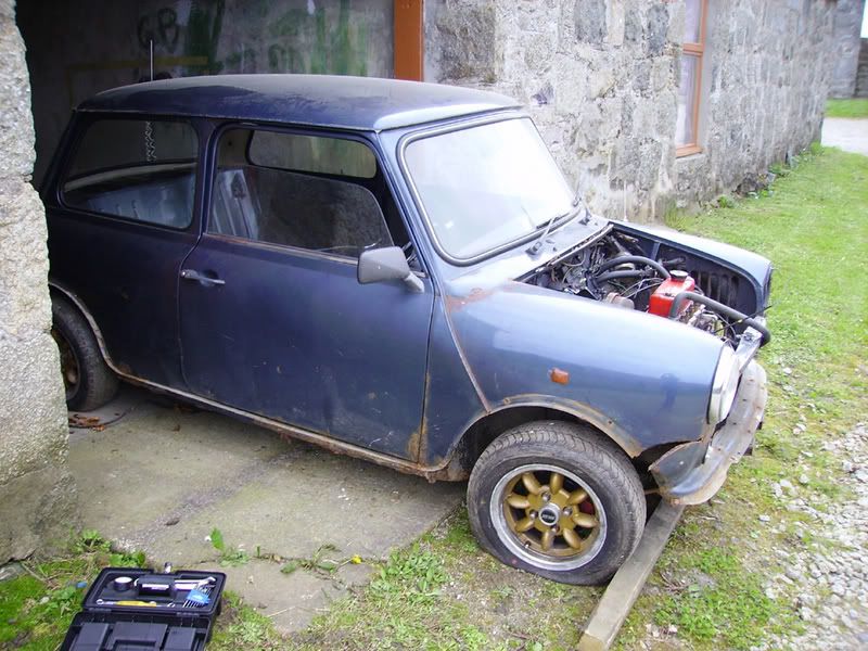

Here it is when i pulled it out of the Garage:

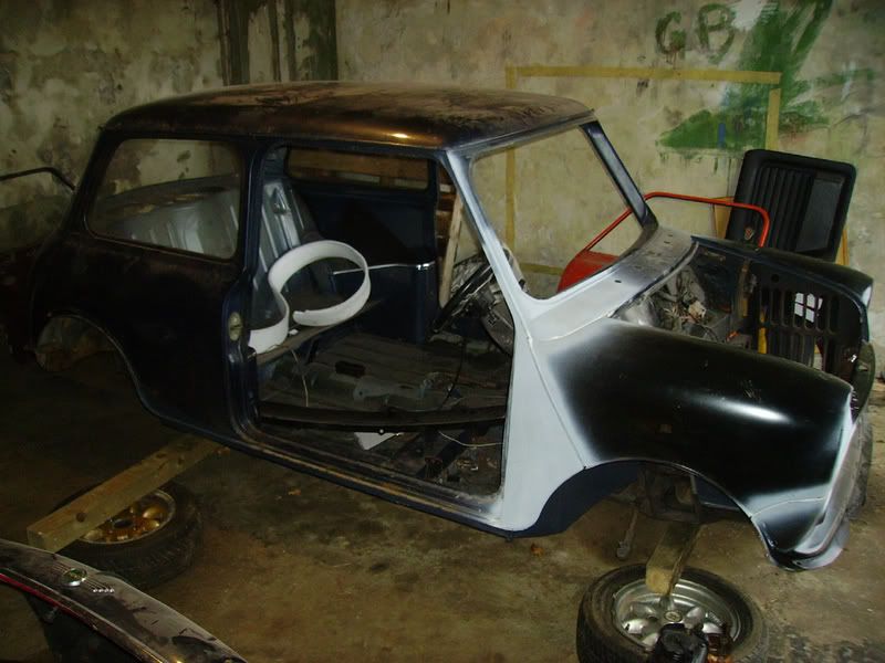

Work commences.
Lots of bits, all these panels are now on and if anyone notices the oversills they were changed and proper sills were put on instead.lol Poly bushed got changed for solid mounts later on. Also got H/D adj tie bars.
Bulkhead has no holes in it but the inner wing was screwed so a new one was put in.

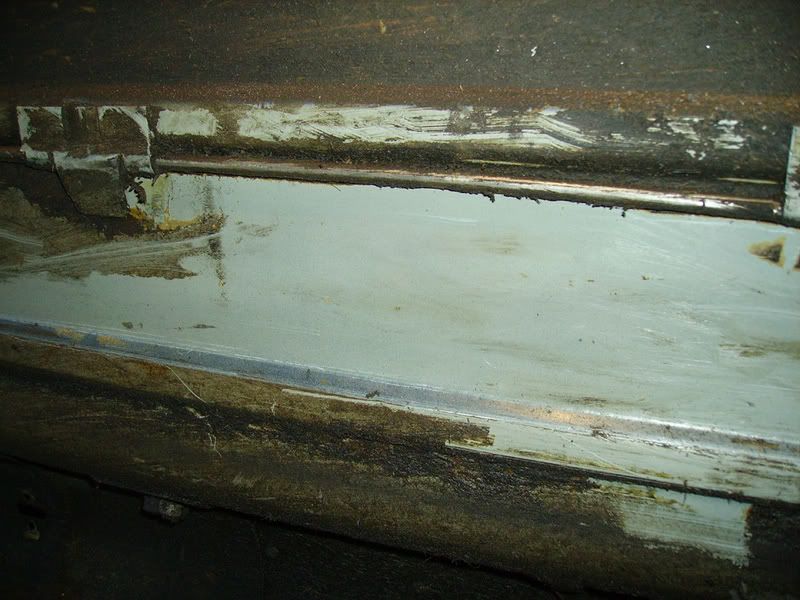

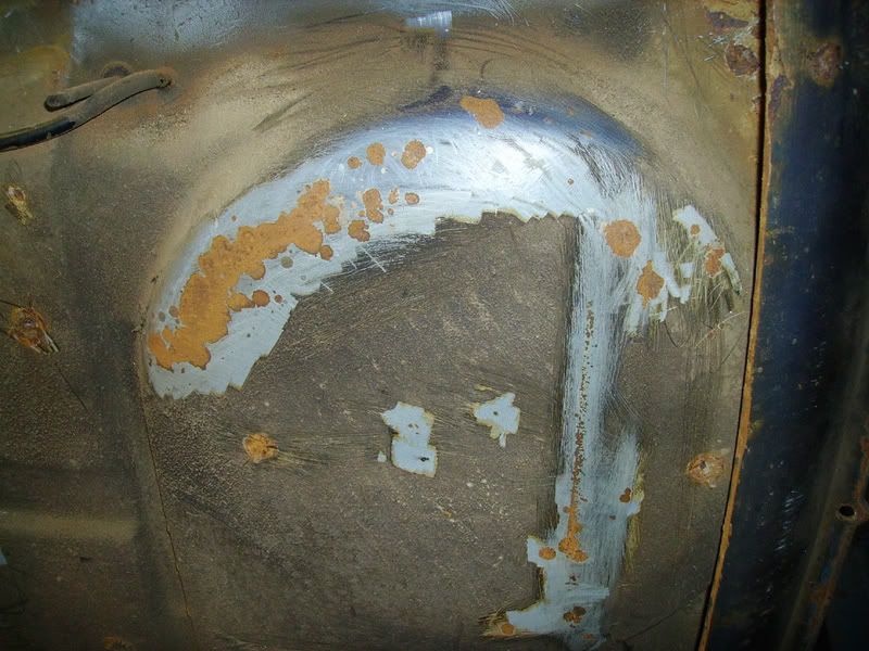

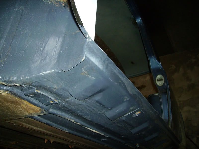

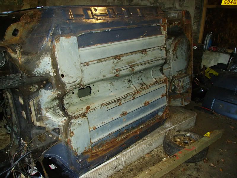

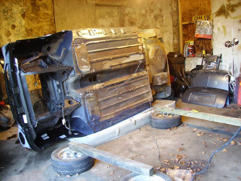

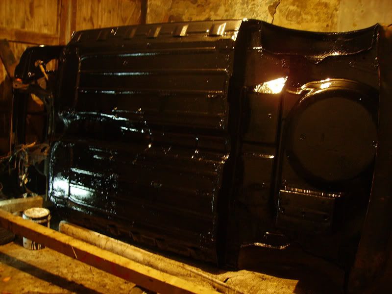

Decided to start doing the underneath. Its in really good nick! Everything is surface rust and theres no holes. Original underseal has lasted and protected the floor pretty well. Just needs a few bits to be ridden of surface rust then re-undersealed!
Its always really nice to find stuff like this. This is what the majority of the floor is like!
Its still not finished as I am going to give it another coat before I waxoil it but it is soooo much better now. Anyways,
Before:
inbetween:
After:

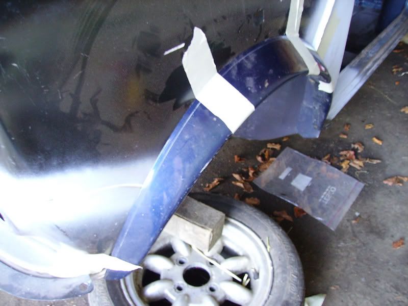

I got my arches too. Wood and pickets. Should look good with 6x12" dished mini lights.

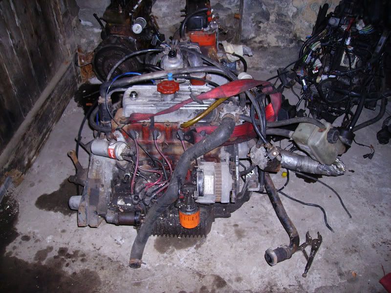

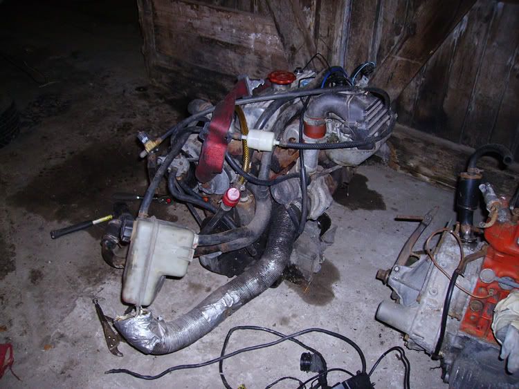

Then i bought this, a metro turbo engine. Apparantley in working order but was overfuelling so i plan to rebuild the carb and replace a few things and see if it runs then rebuild it at a later date

Heres another piccy of the engine. it turns over, turbo spins freely, and inside looks extremely well looked after. I also got the rad from the metro with an eleccy fan still attatched so il try use some of that. Got the ECU and fuel pressure reg too. Needs a bloody good clean though and a lick of paint!lol

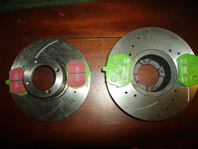

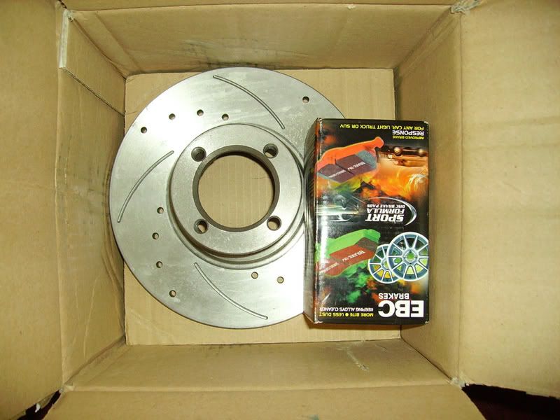

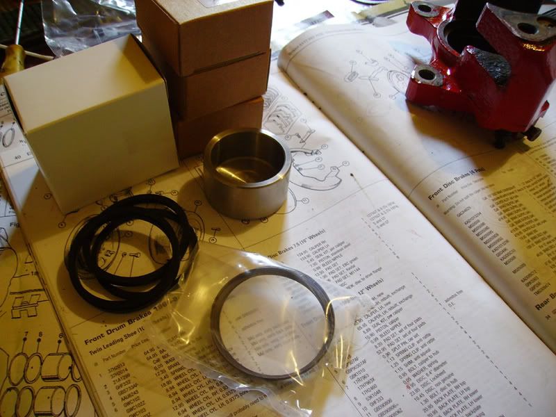

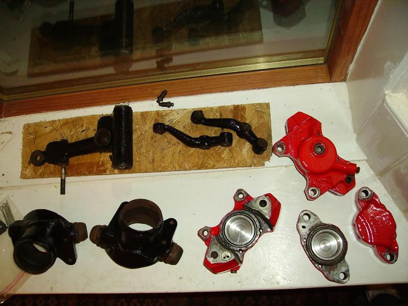

The brake calipers are pretty much rebuilt and painted red. Also got EBC
greenstuff pads and sure stop discs from mini sport.Should look lurvely, hoping they work ok tho as iv heard a few bad things.lol

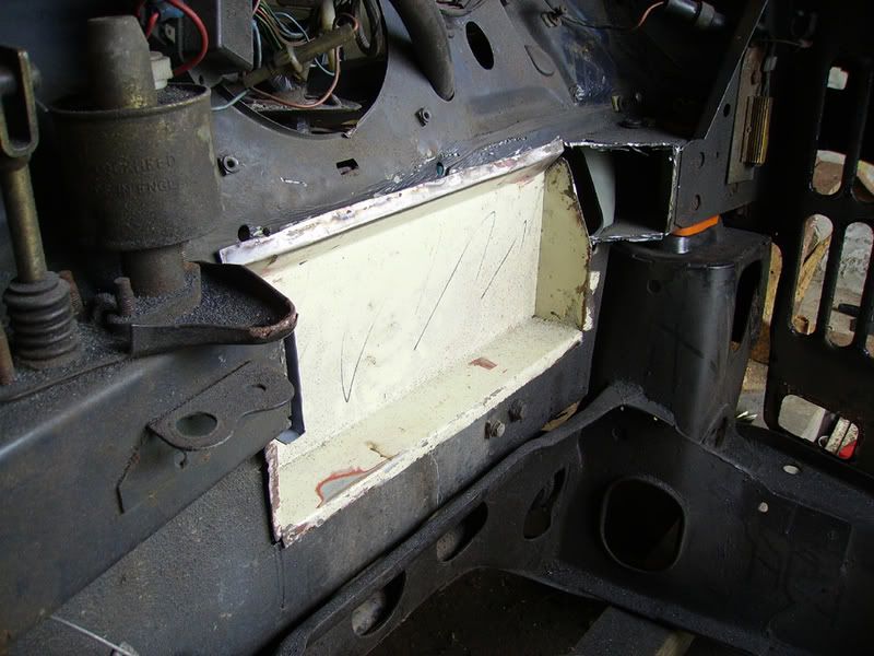

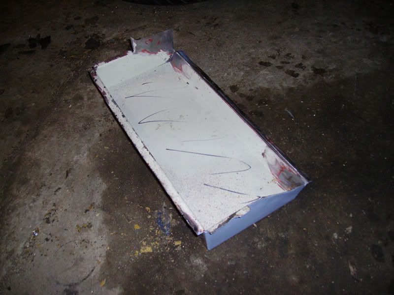

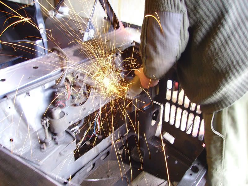

Cut out the bulkhead box the other day. just waiting for my mate to weld it in and i can get the engine bay cleaned up, primered and painted in black:
Dad grinding.lol.
Also in the process of painting the engine and rebuilding the hubs. Gonna have a go at fitting a wheel bearing tommoro. waiting for another kit to arrive and i still need to order 2 swivel kits for the hubs and negative camber kit.

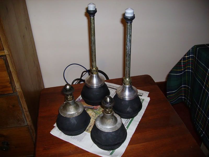

Oh yeh, heres the Hi Los, mini sport front ones, new cones and knuckles:

Oh and iv started to rebuild the carb tonight hoping to get it finished by tommorow. Bulkhead box is getting welded in on saturday morning which means i can get the engine bay painted up and the shell protection finished. Got tons and tons of stuff to do!
The bulkhead box is all welded in now and the engine bay has had a coating of red oxide. Looks braw if you ask me. Chuffed with it.
Welded:
Painted up in red oxide:

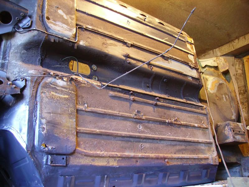

Also started on the boot:
