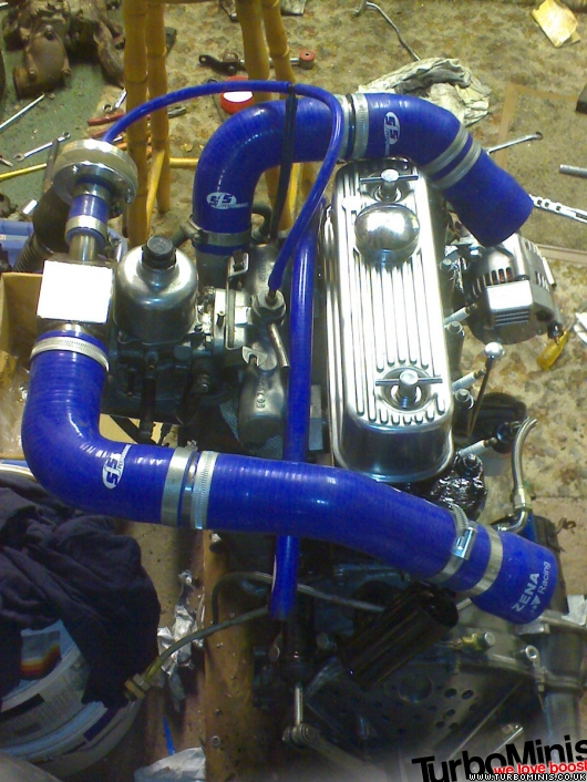

Here is pics i put together as few years back:
http://www.turbominis.com/forums/index.php?p=vt&tid=2850

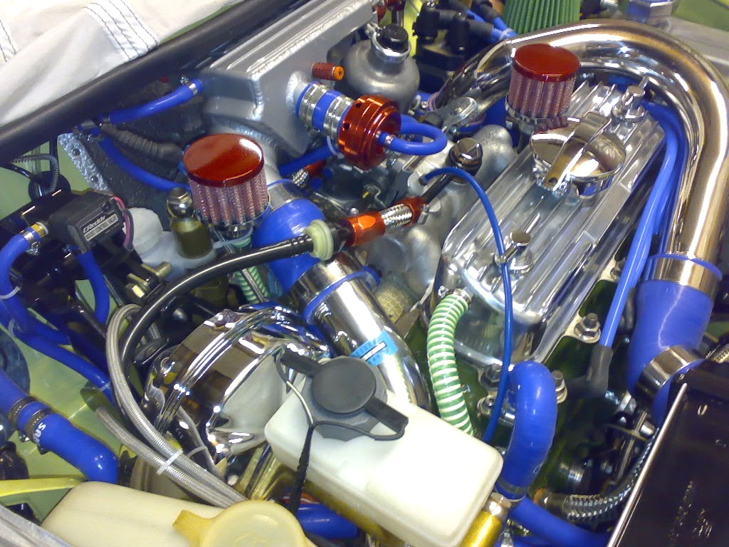

One of Nic's plenums
One of Gialoflys plenums with 2wd Cossie intercooler.

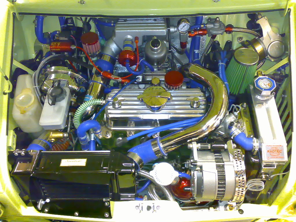

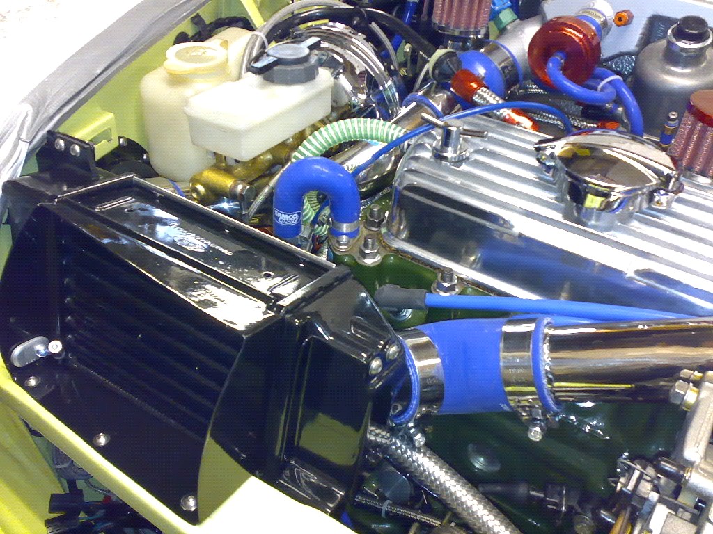

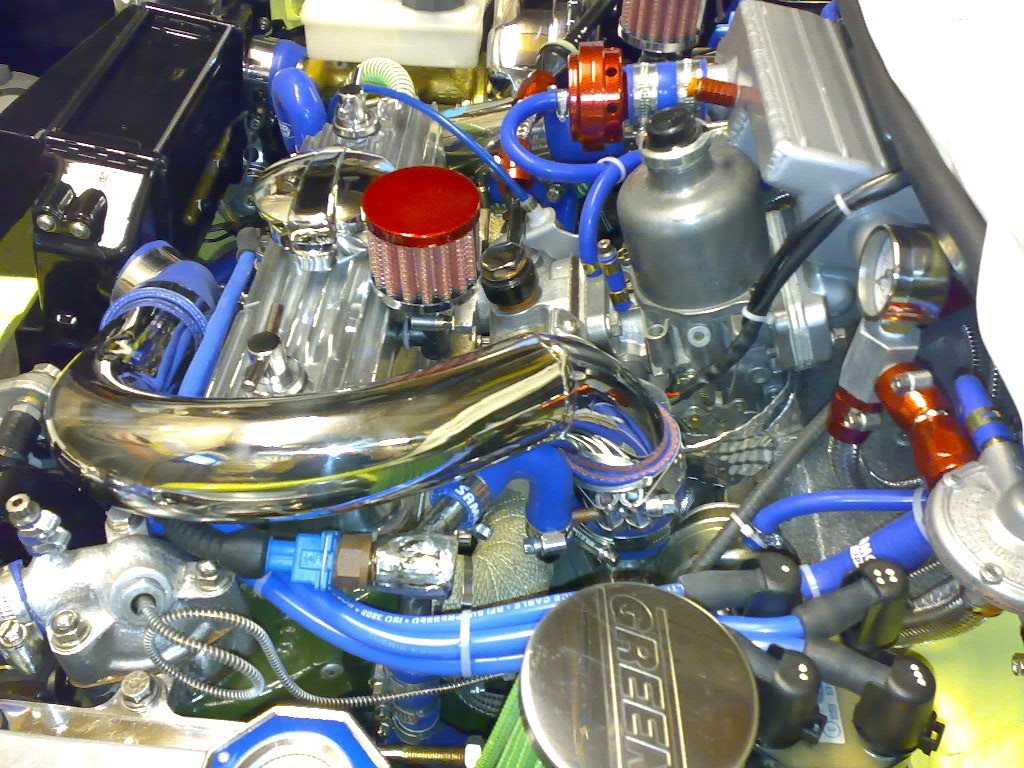

A few pics of my RST i/c install.
The i/c shroud, brackets and pipework are all home made.
The air intake to the i/c is via three holes in the RH side of the bonnet.
The shroud stops the air from escaping into the engine bay as it enters through the bonnet. All of it goes through the i/c to improve its effectiveness.
Hope the pics help.
Richard.
