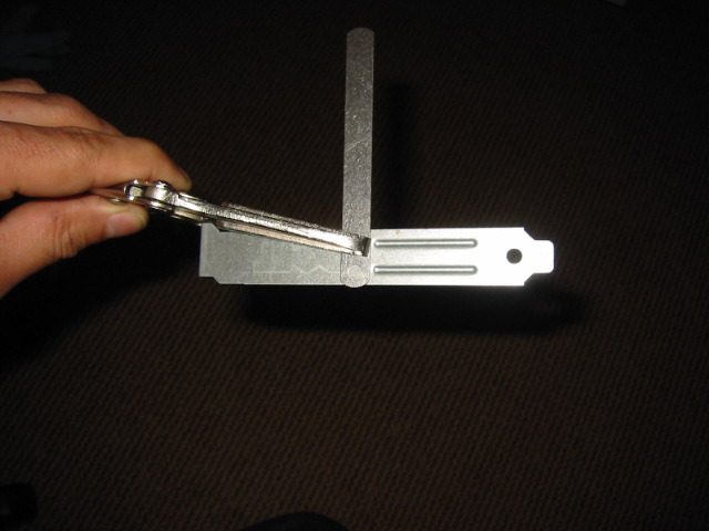

i use this to set the float level accurately.
( a computer slot cover, a blade from my feeler gauge set and a small vice grip)
use a extra 1mm blade to set the depth , then clamp the loose blade with the vice grip
