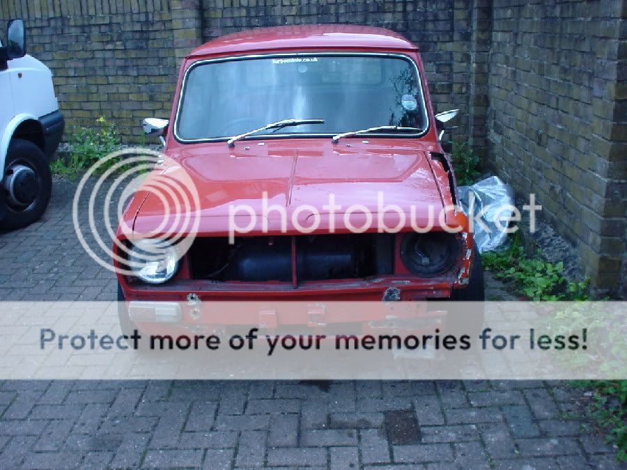

my welder should be here this week, i got a clark 130 gasless one, but it comes with a gas bottle and kit to convert.
i got to work cutting off the old wing yesterday and started tidying up the edges today, hidden rust wasn't as bad as expected but i do have one problem.
the edge of the front panel where it mpounts to the wing closest to the ground (clubman) is a bit fooked. the spot welds have all rotten through so there is no good metal to weld on to there. does anyone have any suggestions for how i can sort this?
can i rebuild the little bit of seam there or do i need a new panel??
pics soon if i can find a host, photo island keeps f**king up.

clubman_dan
1128 Posts
Member #: 142
Winchester
this is the seam i am talking about, can it be repaired is it a new panel i need?
iain
8506 Posts
Member #: 16
Near Lincoln
that will repair very easy. much easier than replacing the front panel!!!
get hold of the haynes manual thats about restoration of a mini, its good for things like that.

by the way here's another pic of progress as of yesterday, got more done today, nearly got all the wing removed.
