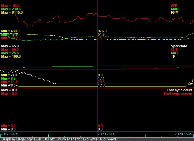

it idles at 14.5-15 afr which is why ive asked its puzzling me i know it first did it when i was sat in traffic and now it often does it at idle,
im going to get some more plugs but would like to cure it first if i can
i havnt got any logs of it doing it but this is a bit of it at idle

if it goes rich enough to wet the plug so it misfires you can end up with the AFR rading lean, tricky to spot sometimes.

That looks awfully bumpy and 'peaky'
How is the idle? is there a slight misfire? Is it one or all plugs? Remember that if you suffer rich missfire, it will show up on a wideband controller as lean. Not suggesting that this is what is actually happening here. just be aware of the fact.
Wet plugs is either fuel or oil. For the plugs to become wet in a running engine, there has to be enough fuel or oil to quench out the flame. Too cold a plug can also cause plug fouling which then leads to missfire which then results in a wet plug, and more likely to happen at idle than full throttle
