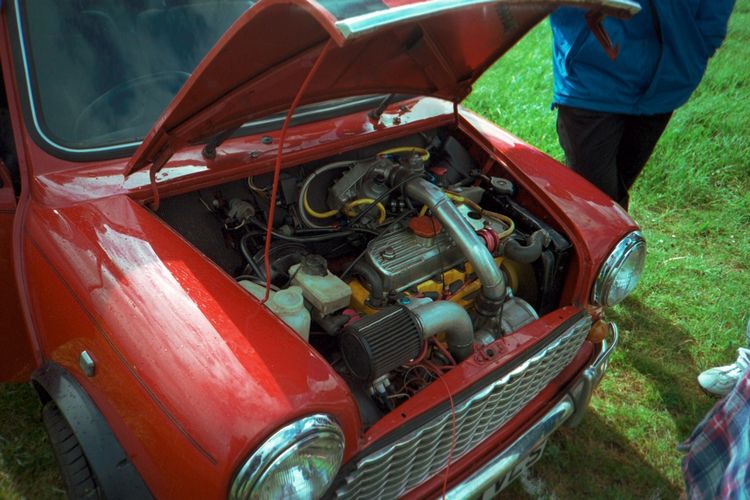

rumour has it there has been a mini using a rotrex, does anyone know any more info?

There was indeed a mini with a Rotrex. Guy was in Scotland or somet. I think Evo knew who it was....

I seen a red one in a minimag yonks ago. Ill dig it out if you want.

That is the same one.

I think this was the one at the IMM in scotland, some years ago...
