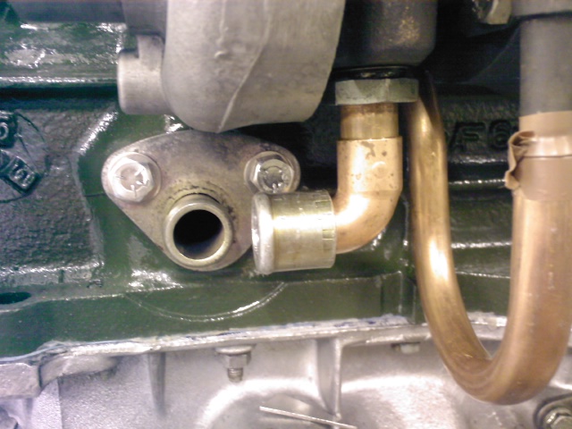

My R5 style T2 has a 22mm oil drain, whats the ID of the T3 oil drain hose? Can I use this (I will mod my fuel pump blanking plate with a 90 degree bend towards the turbo)? The reason being, a fluro lined 90 degree hose to suit is over £20 new! I notice some of you use a normal silicon hose, how has this worked for you? Thanks again!

I used a std metro hose cut down, but my oil drain is a home made one that uses part or the R5 item.

like so

Ah yes, thats interesting. I was thinking something similar but like this:
I have to fab the blanking plate yet so I thought I could throw a bend in it. Thanks for the imput.

thats normal silicone hose in that pic jay

Yes your one of the nonfluro-ites I see. What's good enough for 216 bananas should be good enough for me! If I can't get a standard T3 hose then I'll thow on a silicon one. Thanks guys!
