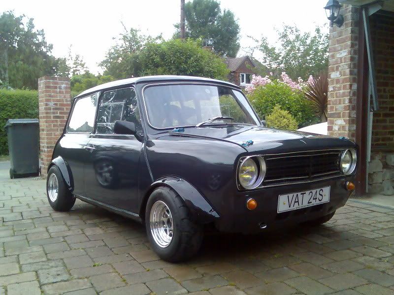

As the title, its one of the mods I want to do on my car, which will mainly be used for road and track.
Im curious about the sliding front windows? How do they fit? Do they rivet to the outside of the door? If anyone running these could explain or has any pics it would be great!!
If youre not sure what im on about i mean the polycarb windows on the doors of my mates old car like this:
Also, as i said they will be on a road car, and living near portsmouth theres pikey scrotes looking to break into anything.... are the sliding square windows easy to open from the outside??

EDIT: it looks to me like they sit in the oringinal sliders. but seeing as i am going to be using fiberglass doors i might need to find some other way to do this! as for locking then im sure that you could fit some sort of catch to the inside of them so as that the cant simply be slid open from the outside?

and they fit just like MK1 windows, I don't have any pics I'm afraid as they are currently up in the loft as I supposed to be getting the shell blasted shortly.

Rob no worries about the pics - could you explain how mk1 windows fit as ive not come across them before. Do you wind the window up and sit the poly window onto the rail that the normal glass would sit on, then take off the handle?

The door one's fit into the seals and a few small self tappers under the internal bottom trim hold them up

acw don't seem to have any locks however the main window has 4 holes in it. with a slider that is on the inside.
if you have the 4 holes you may end up with choccy papers in your car but they arnt going to be able to get their hands inside to the locks.

Thats true, 4 holes sounds like the way to go!
I was less worried about choclate rappers and more concerned about dog turds and matches (im from near portsmouth).
Thats if they can even manage to get the slider open what with a bigger square hole being harder to get round.
