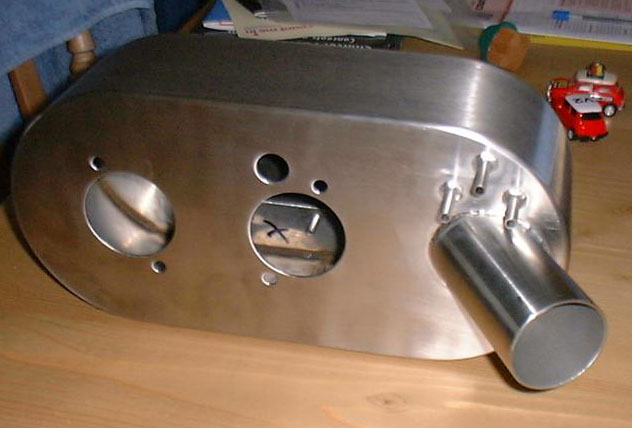

Yes it is a dellorto you are correct. A mate worked for lotus some time back and managed to pick up a pair of dellorto 45's as used on the lotus esprit.
Currently putting some miles on the clock before I goto the local rolling road. Spoke to them this week and they are more than happy with me working with them configuring the Megajolt etc.

A bulkhead box was required - see picture attached
Didn't have the lotus plenum so had to design one (not sure if the lotus one would be one big one or per carb?). Based my design on a weber/dellorto N/A K&N type air filter.
The combination of the dellorto and megajolt make the idle very stable - something I used to have a lot of problems with years ago when I had a SU - could have just been not setup correctly of course! :)

that plenum is pretty and would suit me rather well did you buy it or make it yourself?

A friend of mine made it from the plans I gave him, almost 8 years ago! He was bloody good at what he did, you can't see any of the welds.
I think I am going to wait until the next MegaJolt firmware/software update (due fairly soon) before I take it to be setup properly. Would like to use some of the new features to control the electric fan via the Aux input, and the advance retard control.
It drives remarkably well considering I am using a combination of the Lotus jets and some I bought to ensure it doesn't run weak on boost.

I take it it works fine without restricter rings in the plenum then?

Yes, so far so good. I just have the standard dellorto trumpets inside the plenum

i like that! can i ask tho...whats the noise like? i had a dellorto on one of my mini's and sounded awesome o imagin this with the turbo has got to be even better

Unfortunately the noise isn't as cool as a N/A engine on a weber or dellorto. There is a deep growl, but all a bit muted really.

i guess dampened by the plenum? ah well! definatly good going, id be interested seeing more piccys aswell, all custom manifolds i guess?

No custom manifolds just modified ones. Had to a file and grind in a couple of places to get clearance between the inlet and exhaust manifolds.
I suspect this might be avoided with the use of different inlet manifold, I wanted to use what I had in the garage.
