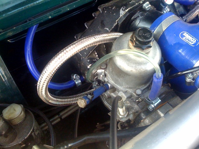

took me ages to get my daughter to upload them for me let me know if thers anythink wrong

The clear pipe that I presume you have running to the dump valve needs to be blocked off or connected to the othe pipe that you have blocked off.
The dump valve signal pipe needs to be connected into a nipple on the inlet manifold or a sandwich plate between carb and inlet. I think Nick is coming to see you tomorrow, I may be able to come too and help you mate.

thanks a lot realy apreciate it , the clear pipe by the way is to the boost gauge but befour I change anything will wait for nick and yourself
see you tomorow
