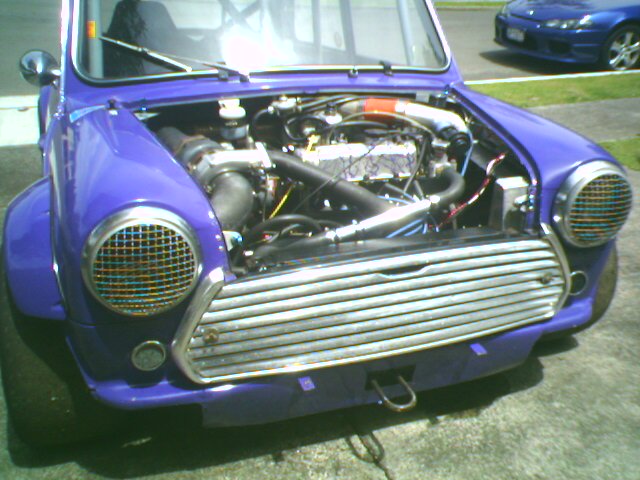

I have a Canadian Ex Works Mini Racecar that was bought out to NZ in the late 1970's. It was campaigned by Abingdon Motors in Vancover and won the Western Canadian Saloon Car Championship 2 years running as part of a two car team. Car was originally pearl white with Abingdon Motors accross the top 1/3 of front windscreen.
It is an April 1960 shell (one of the lightweight shells from the first 2 years)
I bought the car about 11 years ago, with a 1430cc engine with a Richard Longman inclined value head on it.
It is now running a 1370cc 5 port engine with a large Ball bearing Garrett turbo off the last of the Z31 3.0L V6 300zx (single turbo) with a custom intercooler and a HIF6 turbo carb from a 2.0L MG Montego
Approx 200hp on 17psi, lots of fun!

Looks like the intercooler is side-mounted. Is there a fan on it ? Air extractor ?

Yes, it is side mounted, there is a alloy duct under the guard which routes all air that goes thru the open LH headlight hole thru the intercooler, then there are also vents in the bonnet to let air out. No fan on intercooler or Rad, also no alternator.

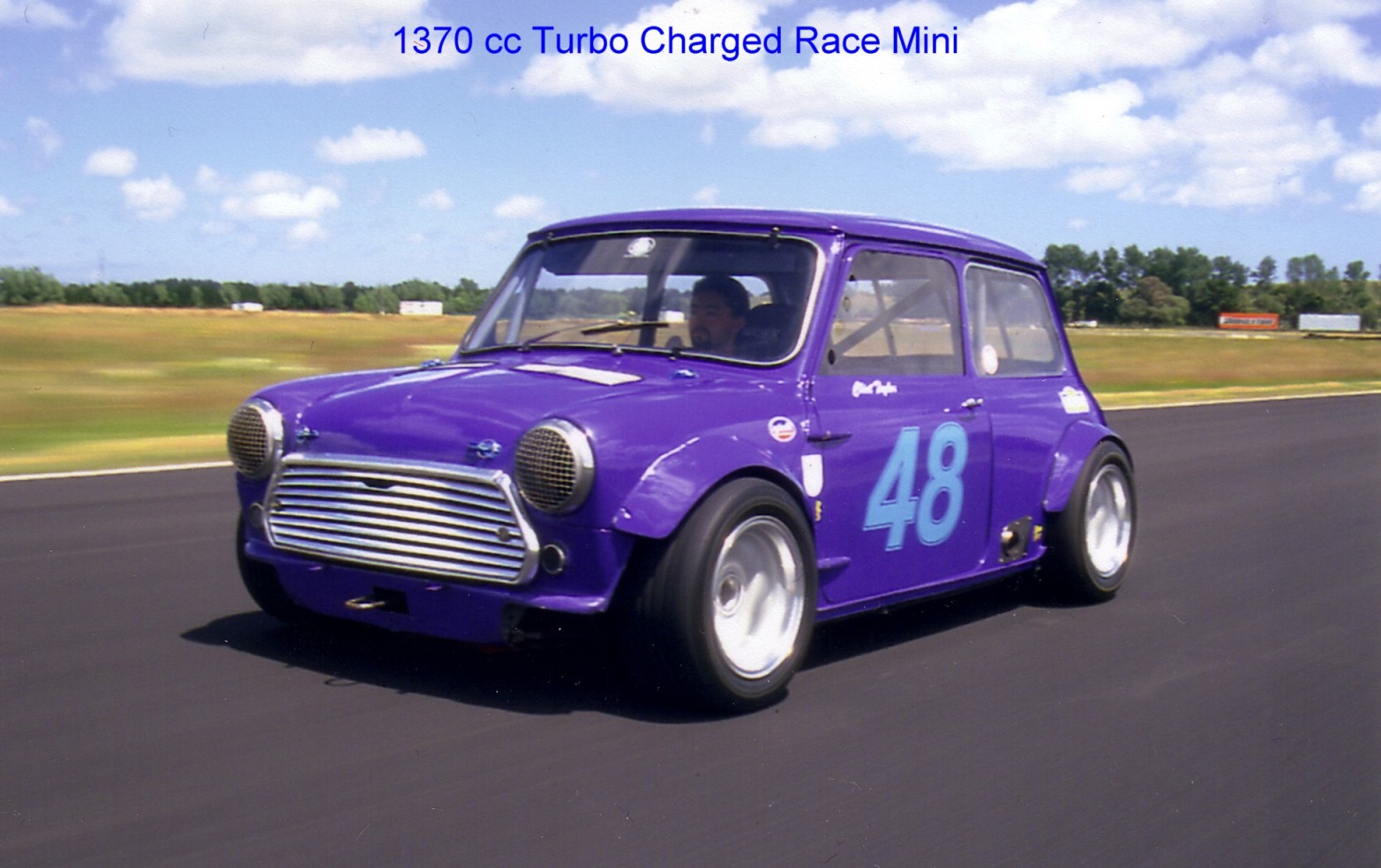

Thanks! Yes there was a little pic in Mini World quite a few years ago now, prob 8-9 i would say, it was like this back then. A photographer from Mini World drove it on the track (and crapped himself) it was running much lower boost way back then too *wink* The pic of the car on the track was actually taken by him, hanging out the back of the boot of a car driving in front of me.

Raced it in anything from Super Mini Challenge to classic car racing events against 600hp Holden Monaro's etc, with much success.
Havn't raced it for about 3 years now. It has a freshly rebuilt engine.
