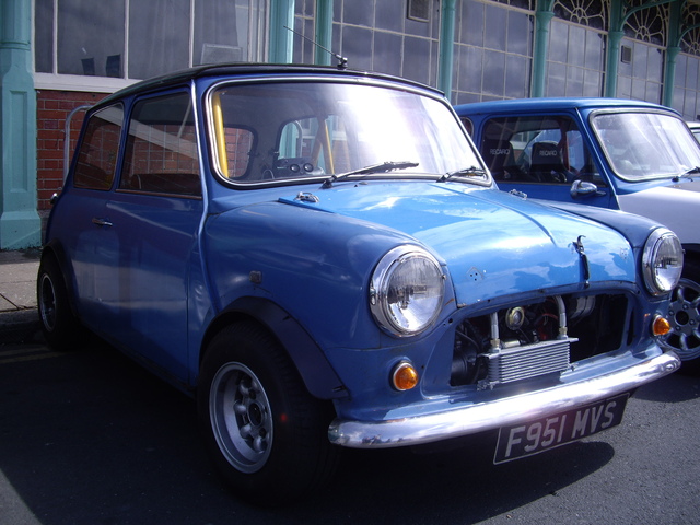

been doing some reading and research and i think my cr might be to high to get down to a decent level in order to get a decent amount of boost (blocks been decked i think) without using a decompression plate (which i'm unsure off tbh) so may need a new block...anyway its all WIP :) got alot of reading to do and whether a charger or turbo is the way forward *happy*
pic from the weekend better than the other one
www.twitter.com/lilpinkiy
Go Turbo!
Edited by MikeRace on 9th Jun, 2008.
6297 Posts
looks ace. Just my sort of mini - low, wide, and cute! *wink*
Looks good,
the block having been decked should not be an issue, on most std engines the pistons don't come right to the top of the block as they should really do,
I'm personally not a fan of decompression plates, plus you should be able to get the head chambers taken out to lower the compression ratio for not too much cash anyway. Benross on here does head work and can do this.

new wheels (wellers) and slight change in bonnet colour :)
