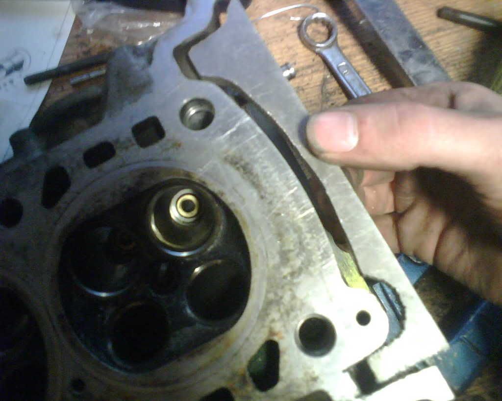

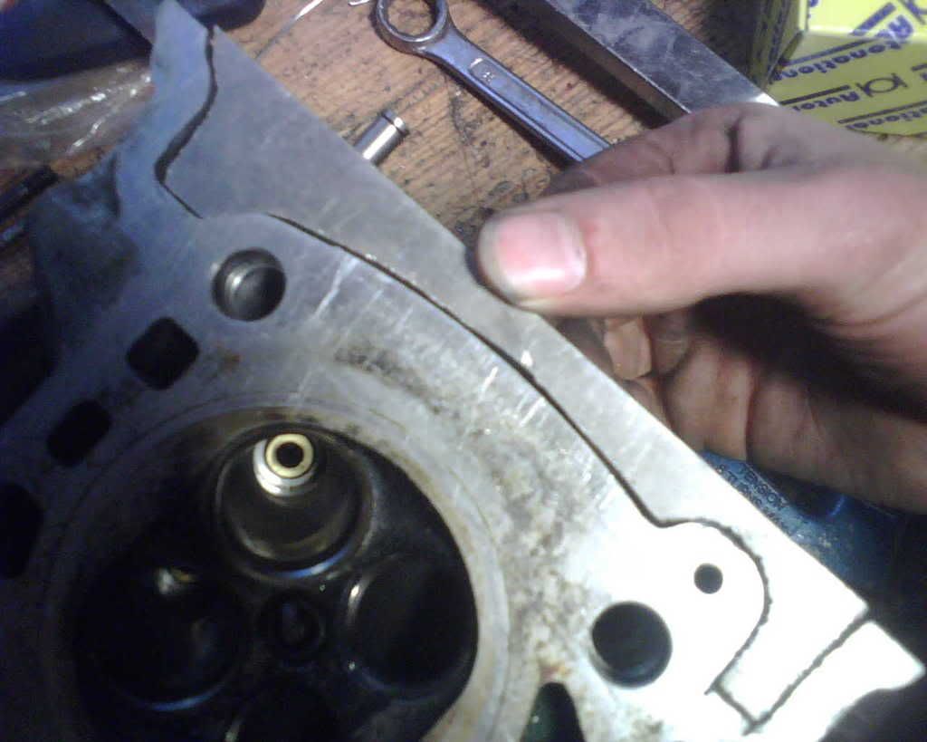

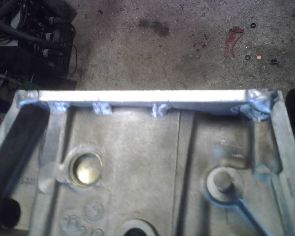

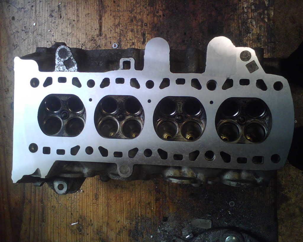

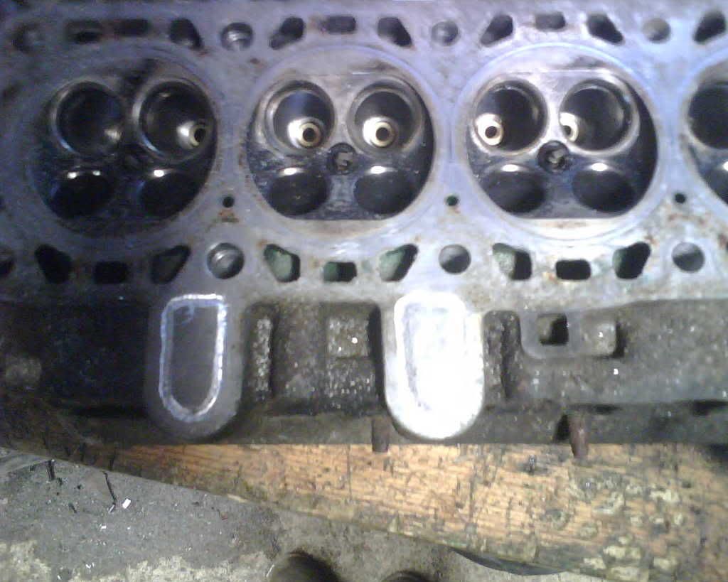

Hello all Very Impressed with the sight a super welt of knowledge exists here well done all, So who am I well, I am a race engine builder from the South of Ireland and have been predominately building A series race engines in the last two years Below is my first Step away from 5 port into the big bad world of 16 valves I have welded up the cylinder head to JK spec and had it machined by a top bloke up the road from me the block is in the machine shop at the present and when it returns I will get some pictures up this motor is to be planted in to a late 80s shell which I am in the middle of building to Irish race speck I shall have some Pictures of that up later in the week

looks good mate, whats the head off.

sore TH probly could have made that a bit clearer Is a BMW head
