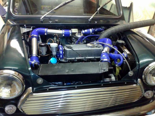

"Little Bit of Cake". Thought i should join in.
Still gotta find a space for the air filter.

4wd coolers really are massive! Engine bay is looking good though. :)
now thats what i call a nice big slice of cake shaun *Clapping* *happy*
Looks a lot like mine did with the 2WD Cossie cooler. Good job! It looks great.

Cheers for the comments fellas. Got the intercooler for 5 quid off ebay.
Theres a fair bit left to do yet, gotta wire up MJ, fit the exhaust. Then should be ready to start the engine hopefully. But i still need to sort out the interior, wheels and arches.
Just money that is slowing me down at the moment.

nice, looks like a really neat install
now thats a proper cold air feed *wink*

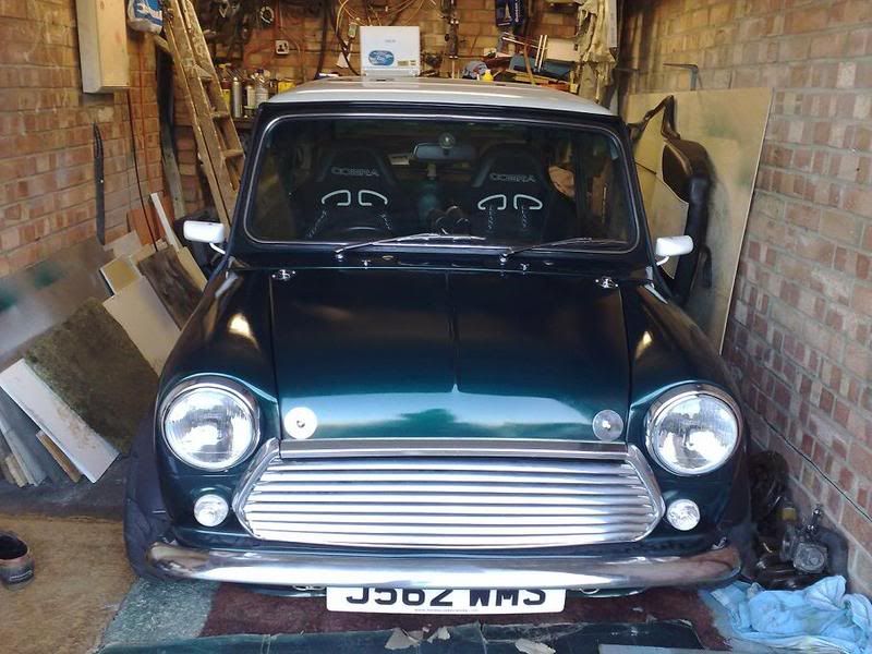

Just had my mot today. And it Passed ! *happy*
Just needed the headlights adjusted and that was it.
Couple of things i have still got to sort though, my electric fan didnt kick in for some reason and the water overflowed abit at the end of the mot were they left it idle through out most of the mot.
And something im abit worried about, but havent drived it properly so cant tell. But on the way to the mot garage, i had it up to about 3000rpm and my vacuum gauge was showing 0psi, so the turbo must be doing something but i thought t2s came in at about 2500rpm.
Oh well i will soon find out, just gotta get insurance and then tax. then i can start running it in and get it set up properly
Few photos that were on my phone:
Edited by Shaun87 on 18th Oct, 2008.
Yay!
its likly to only show about 0 psi on cruise/part throttle,
do you have the fan run through a relay or straight to the rad switch? the fn on its own is likly to kill the switch.
also, you may want to watch out for the law with those arches, ask me how i know :(
also is that a bottom rad hose i spy on the rad-thermostat?
Edited by Joe C on 18th Oct, 2008.

Yer it was a bottom hose i was using, so that i could run water through the turbo. But i have changed it now since that photo was taken.
Its a revotec fan so its got an adjustable controller with a relay.
If i did get pulled for the arches, what are they likely to say? just a warning?

depends on the officer,
I essentialy got my MOT revoked, was issued a PG9, they list any defects and take the milage to check you don't drive it anywhere.
