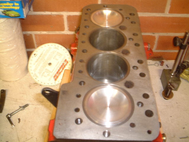

Having the block machined for a group A gasket is a fairly intricate operation and would need the engine removing and stripping down, and then taking to a machine shop. It is a bit more than simply a countersink.
You can just make it out in the pic below.

There's a picture of my block machined for the GP A gasket here, if you can't make it out in Toms pic.
