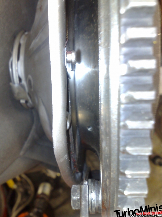

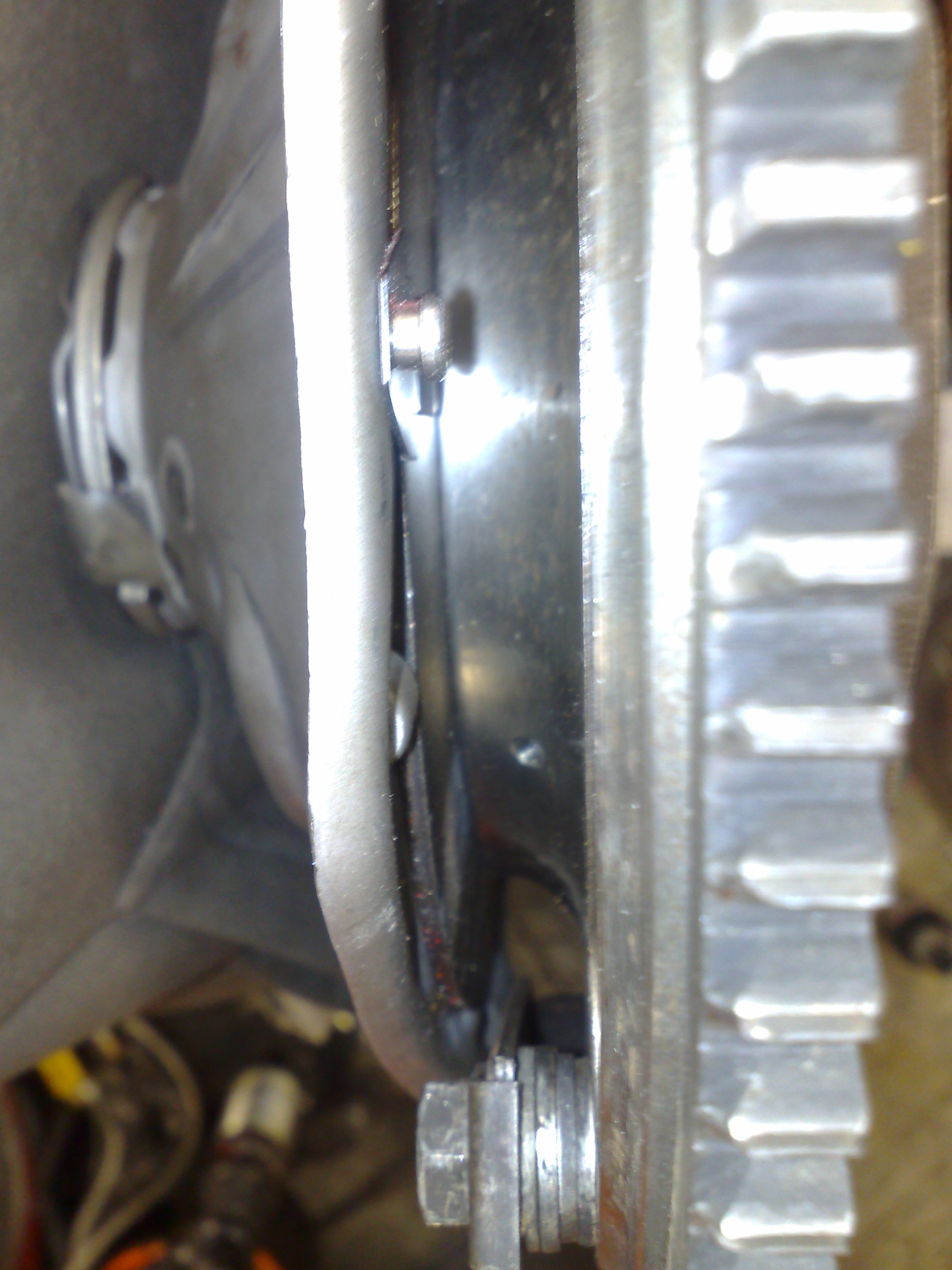

this is whats wrong
Stevey said that mate, i can wiggle the plate around tho?
It will move toward the engine 1/2 inch.
Think im gunna have to pop the flywheel off tomoz.
yes pull it mike

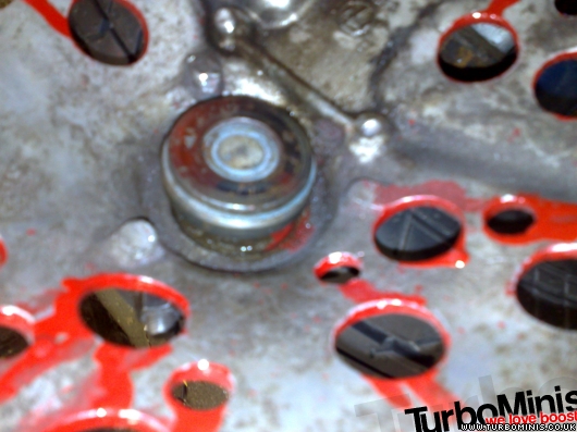

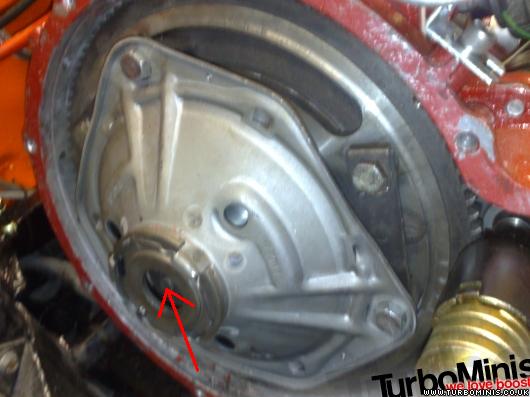

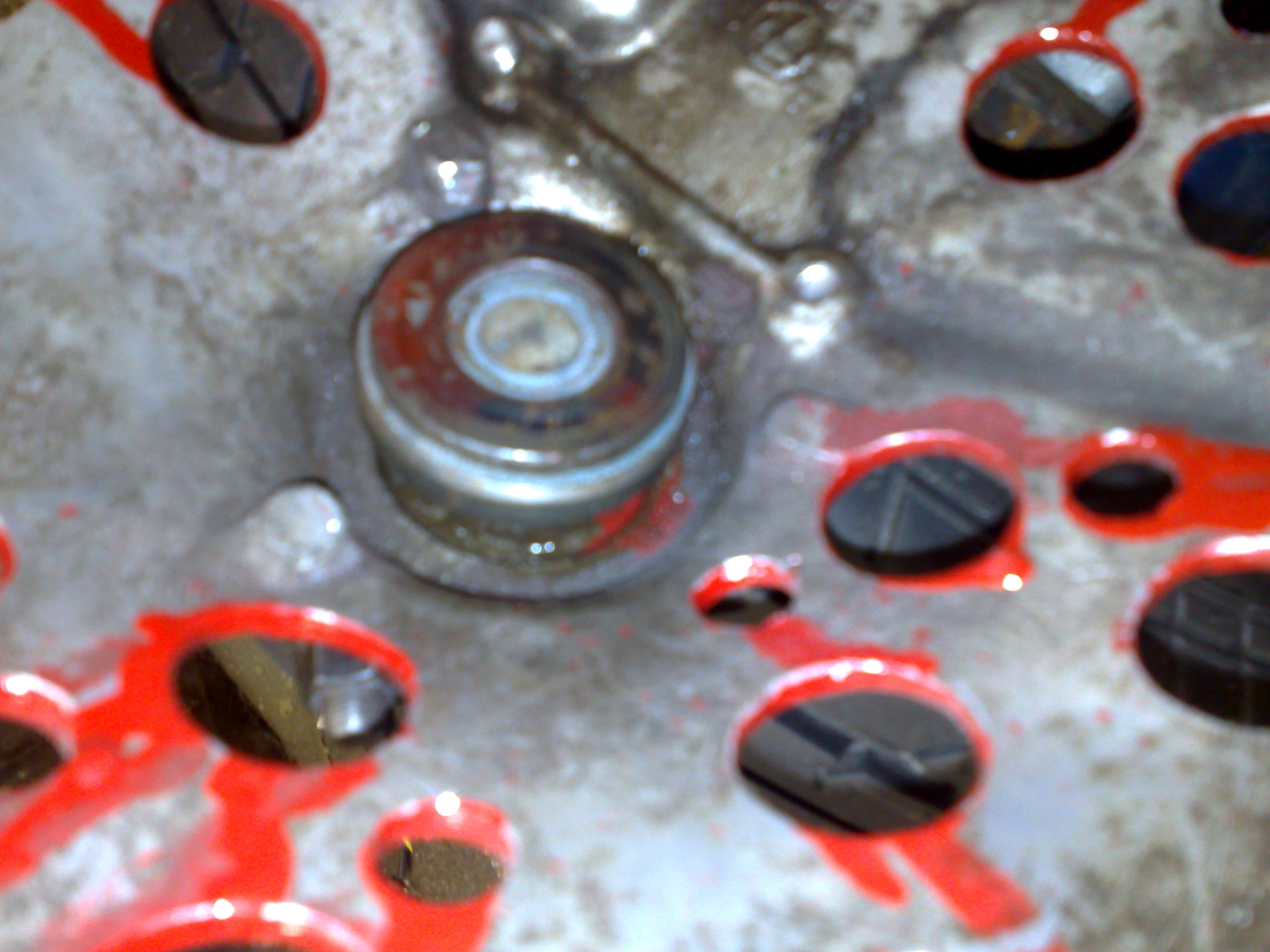

What Plunger are you using Some dont have the hole in the centre if yous dose not it will look up agenst the niple on the flywheel bolt marked in red in the pic
On 17th Feb, 2009 Rob H said:
the release bearing doesnt have a hole on the middle! Not that i can rememeber anyhoo. This maybe the problem. What does the nipple do exactly. i might just saw it off and try again.

From what I rember the niple is there to centrlise the little shaft the relece bearing sits a kind of suport spigot all the new bolts you get from swifttune and Mini spares MED ect ect dont have them so I see no reason you couldnt cut it off

well found the problem mike and i
it was the back plate, the lugs were machined off some 5 mm more than btm limit .... *surprised*
the guy who mike bought it off said it was fine! *surprised**surprised*
this could have never worked as the pressure plate was FULLY clamped on and no more scope to release to disengage the back plate.
anyway mike has another and fast carl is machining 1.5mm of the lugs as i type, top man carl *happy*

Ahem!!, not quite steve, , mike been over and the offending backplate has only had max 0.060" off so not the 0.200 as you suggest. anyway. i fettles up the replacement lightweight one he brought along, so he will use this,
ive explained all the critical dims to Mike, and he is at this moment hopefully checking parts and doing a dummy build.
the suspect backplate in my opinion has not had enough removed to cause the severe problems mike is describing,

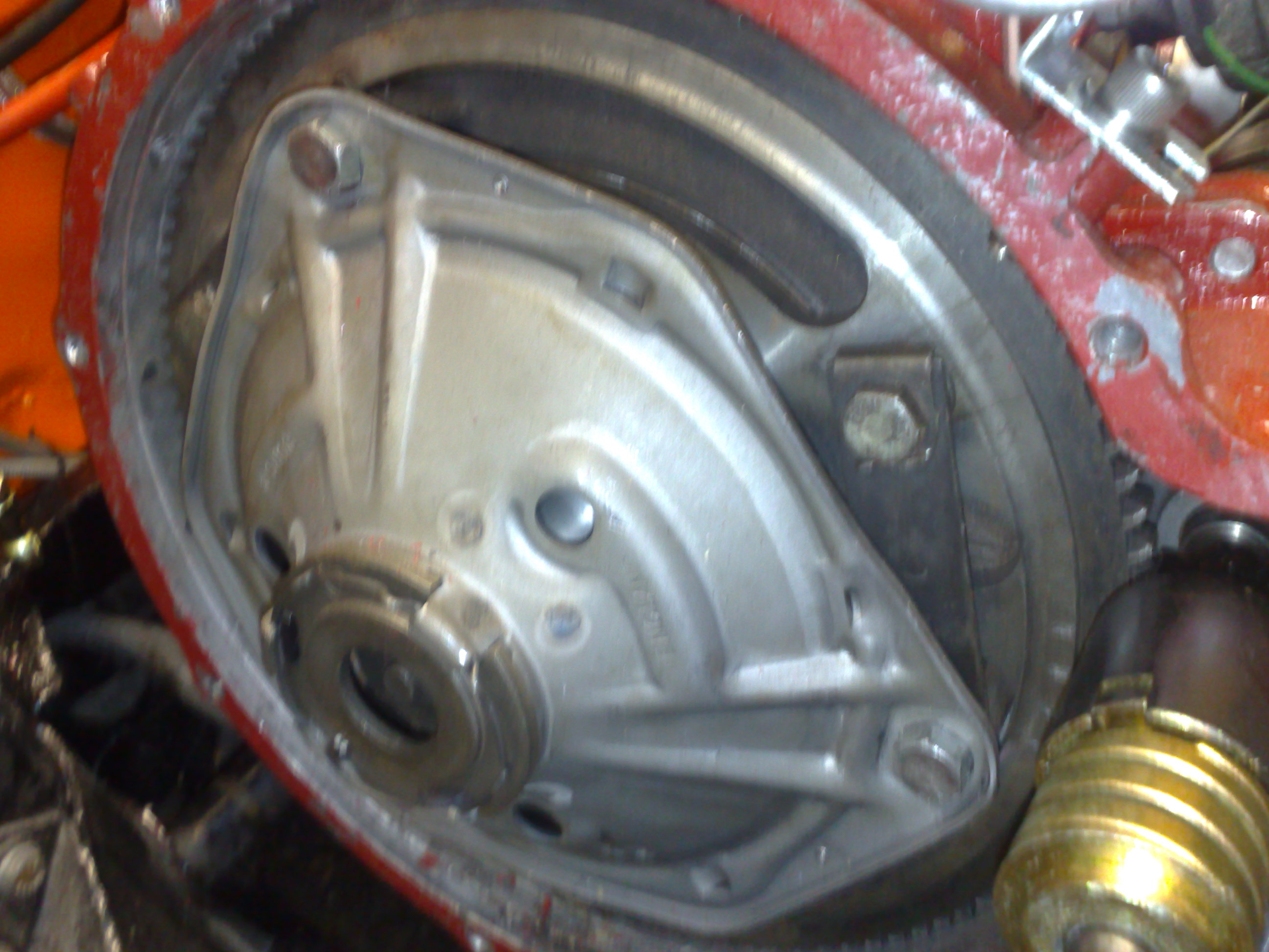

Firstly a massive thanks to Steve for coming over and going over the clutch with me and Carl for sorting out the backplate top fellas!
Ive had the backplate fitted and it seems to spring in a little more but less than i expected. Ive bled up the clutch and it does move and may work but i wont really know until i get the engine going and try moving the car. Carl i measured from the flywheel face to the pressure plate locating ring and its 22mm i did the same on a standard item and its exactly the same so this rule that out.

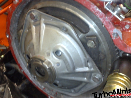

Heres a pic of the setup and does this look ok??
It could be me not being used to how heavy a race clutch is as ive only ever used standard items.
6966 Posts
cover looks perfect, but whats that on the release bearing, is it some kind of washer, come to think of it ,it looks like a verto release,
