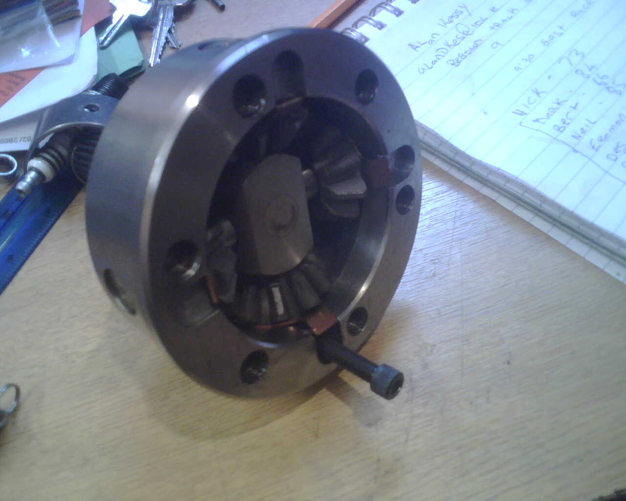

Yes the bolt is a cap head as in PIC I am not back in my work shop just happned to have this pic on my phone the bolt is the same tred as the bolts that hold the gear box to the crank cace some one on here should know what that is,
Regards'
Paul.

Its mont deffently UNF and its smaller than 3/8 so must be 1/4 Problam solved :)
