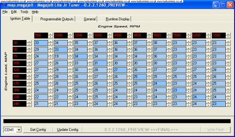

1. Everything seems to be getting really hot. it's got a brand new water pump, thermostat (with the holes) coolant etc and the 'guessometer' reads normal. But everything seems a lot hotter than my previous engine. I don't think that the ignition is too retarded, but I will upload an image of my map and see what you think. Which leads me onto...
2. I've got to drive to (and from) the MOT centre and then onto the rolling road before my car will be mapped properly. What map do you think I'll be better off using for this? I'm currently using Carls map, but there's been quite a few changes since then. The main one being the CR, up from 7.8:1 to 8.4:1.

If the only change is the CR then retard the ignion on boost. If it's at 25 deg already I'd leave it where it is.
This is the map that it's running.
Knowing the engine (have you changed the head?) 7000rpm is a bit optermistic.
Anyway, that looks nice and safe to me. Lots of scope to improve the economy on cruise though.

ignition timing and fueling has a big part to play!
If anything, it's running rich.

that advance below 2000 is way to much in the high vacuum areas..
try it at 12 to 15degrees in a block below 2k and 100 kpa see what that does ?

I will give the timing a tweak as per Roberts suggestion and report back.
