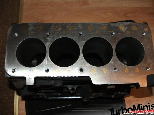

MPi block. Deck completely plugged off for dry deck head assembly, using brass plugs and steel where new stud holes intersect. All new stud locations now have plugs fitted to ensure perfect full form threads.
Offset bored to line up cylinders perfectly center to center with the BMW head. Stud holes drilled and tapped to move the head forward on the block to line up the combustion chambers centrally over the cylinders. All that done on CNC to CAD drawings, so Perfect!
Steel liners fitted to return bore to standard 70.61mm and 1275cc.
Block skimmed so pistons sit flush with the deck.

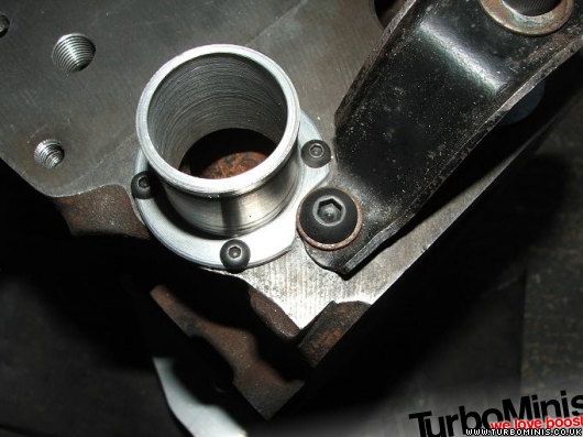

Core plugs have 'safety' retention screws fitted, Probibly not nescisary but it looks cool *tongue*

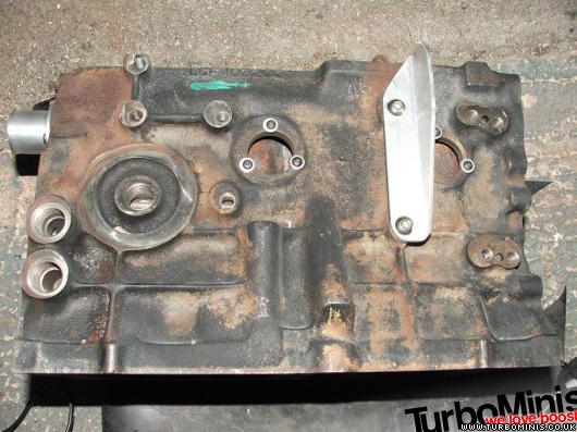

Holes drilled and tapped into old tappet chest for oil drains for both head and the turbo in the very near future
Engine/ Gearbox bolts enlarged to M8.

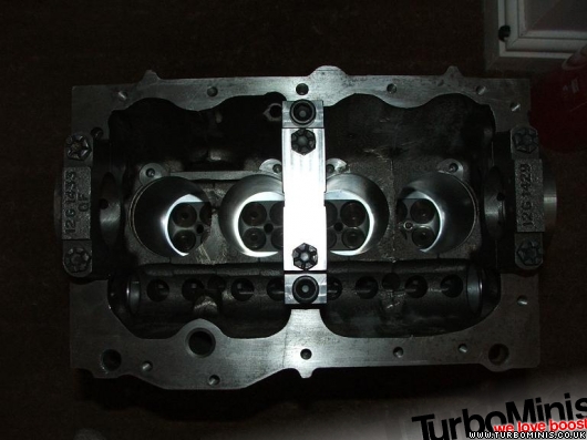

Head modified as per normal plus all coolant passages welded up for dry deck assembly, adapters welded on back end for coolant and oil drain

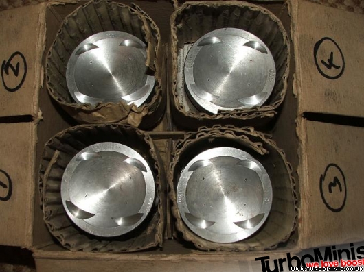

Hepolite 19320 Powermax Cooper S pistons machined for valve clearance. Total Seal gapless piston rings. Teflon buttons fitted to prevent fully floating wrist pins scuffing the bore.
