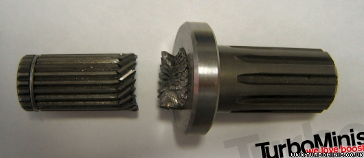

Anyway, during practice, we broke the output shaft on the LSD, not heard of this before, any one else bust one?
It's been in 3 or 4 seasons and done a maximum of a few hundred miles.

It is an interesting failure. It has failed on the pot-joint side, which is basically the same size as every other pot-joint output shaft, be it on a standard diff, cross-pin, whatever.
they're £65 each too!
crickey, what dif is it?
i really dont think this should have happened, its good nothing else suffered from it, but i would def be onto minispares to raise this issue

because of where the break is, looking at one of my JKD outputs, its a one piece affair, and the splines end just before the flange.
the ones MS sell seem to be a 2 piece affair, with the pot joint side spline grooves undercutting it slightly...

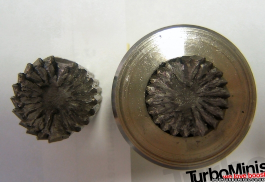

That failure is all wrong for a driveshaft if i'm looking at it right. It appears way too brittle - almost like its had too much case depth in heat-treat.
I'm suspicious to be honest.

To be honest any power and the wheels were spinning. Going onto the grass would have made little difference to the grip levels. I think the shaft has just fatigued over the years and all that wheel spinning did it in.

Perhaps it was jsut an un-noticed flaw in the part? weakening the part as a whole? Not a satisfactory answer as there is no practical solution to prevent it hapening again however :(
i had a similar failure of my driveshafts, im no metalurgist but i did some light reading and came to the conclusion that the twisted, jagged features were signs of a fatugue failure where it sheers a small portion of the shaft eatch time it is loaded up.
