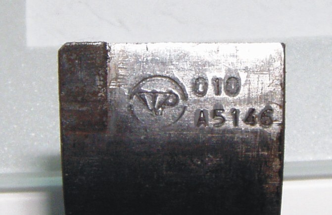

On 17th Feb, 2009 Rob H said:
As above, 75 thou under on BOTH mains and big ends is not credible.
75 thou is also exactly three divisions on an imperial micrometer - do you have the 1" "standard" that should be in the micrometer case (assuming you are using a 1-2" micrometer).
It will be either a small metal disk exactly 1" diameter or a short metal rod exactly 1" long, test the micrometer against this, it should obviously read zero.
As for the markings, see attached.
The symbol is standard for that period (Vandervell I think), the number is probably the part number and (as in this example) any undersize would be stamped next to it (010, ie, 10 thou in this case).
I have never seen these bearings without the undersize stamped so I think yours are standard and the micrometer is set all wrong.
Borrow a simple vernier caliper and measure the journals with that, they are accurate to 1 thou or better if used right.
EDIT - the photo is a 1275 big end, hence different part number.
Edited by Rod S on 10th Jul, 2008.

On 10th Jul, 2008 retired said:
75 thou is also exactly three divisions on an imperial micrometer.....
Surely not.....

yo retired man mine are the same as that but with no markings, i assumed they werent standard because they werent stamped STD but i guess they are..
If they are factory originals they will just have the part number and the manufacturer symbol, no size (no need for a size to be marked if they are original). Replacement standard ones MAY say "STD" or "000" but it's unusual, they are usually only marked once they are undersize.
