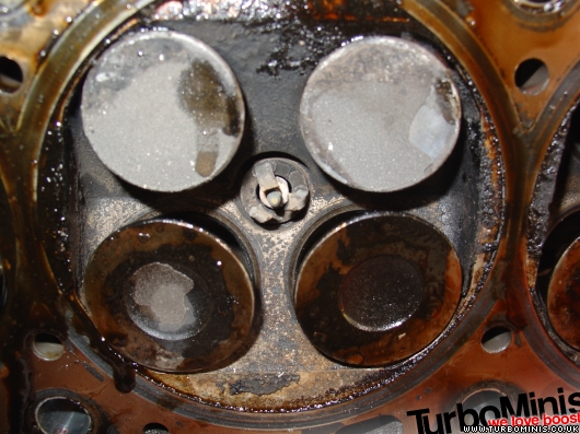

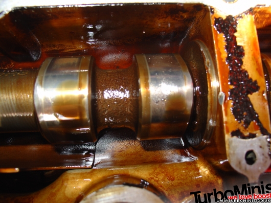

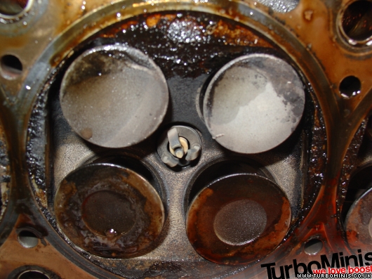

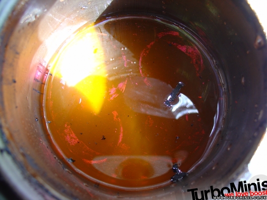

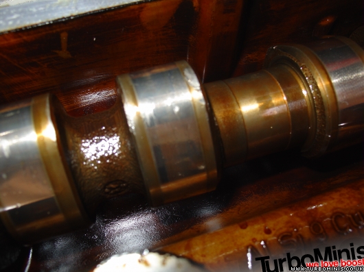

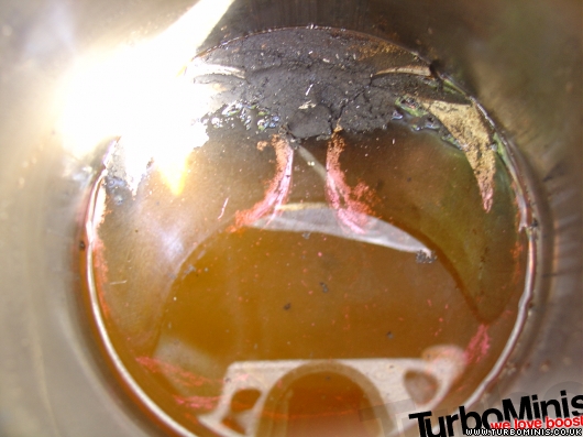

Right... piccys

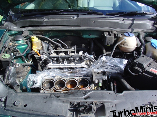

Sorry looking engine bay:

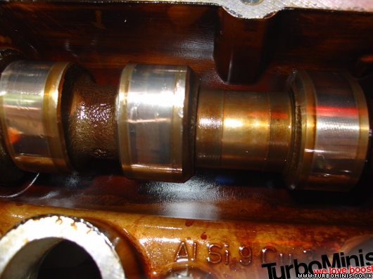

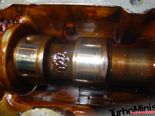

Cam Damage:

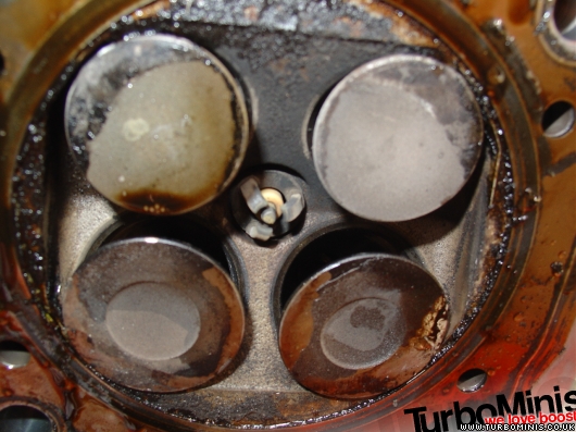

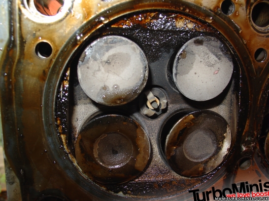

Valves and Chambers:

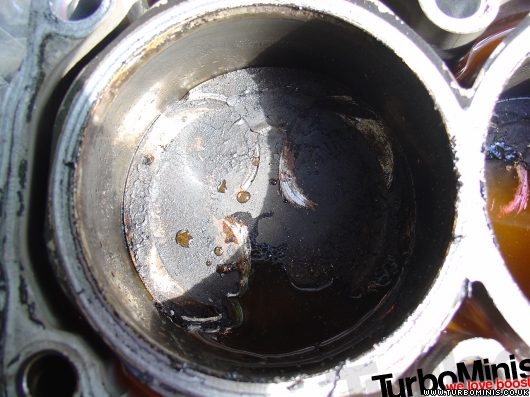

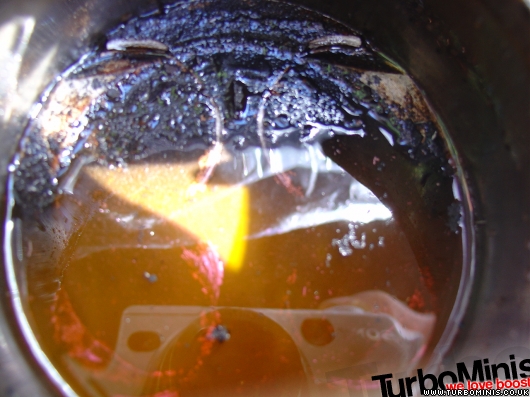

Piston Crowns (crap pics as they're still full of coolant)
Edited by Ric on 12th Jul, 2008.
Get each pair of pistons to the top, clean coolant off and photo again...
Valves are just as I have seen before.....

Get a recon head and nail it all back together...
Those pistons will be fine.

Still a little unsure of the pistons, 2 and 3 look particularly chewed near the edges. Don't want it to pinch on one of the rings.
