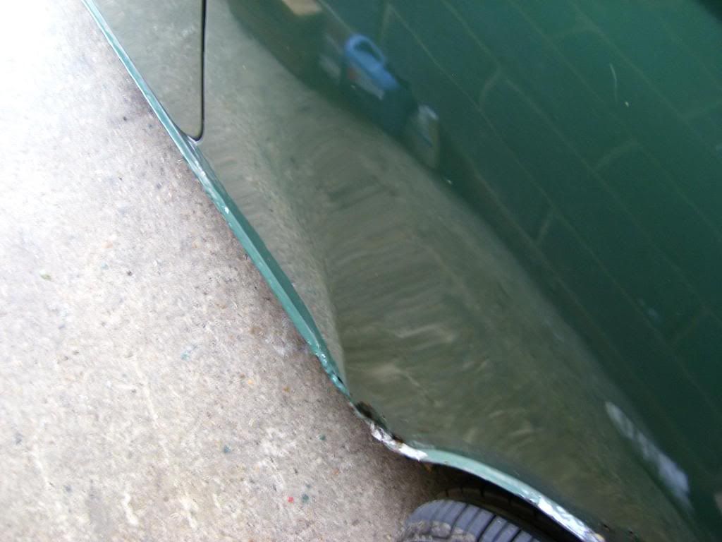

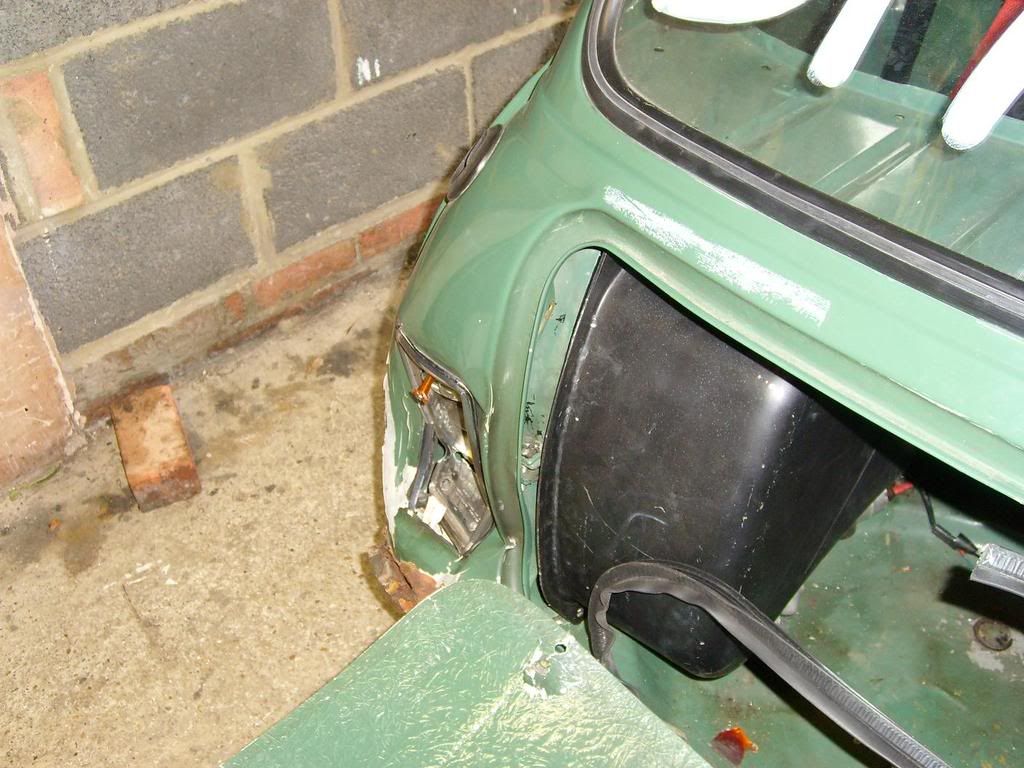

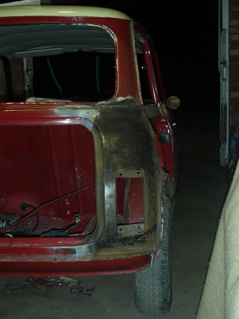

ive had a good look at the damage this evening and tried to take some pictures to show whats bent and what still looks ok. obviously the rear panel, boot lid etc is destroyed but the concerning thing is the rear quarter panel has creased, the boot floor has folded abit and the rear seat back has been pushed forward by the fuel tank and seperated from the rear quarter. after pulling the bootlid back out the damage doesnt actually look too bad in the pictures but it was quite a heavy impact.
i really dont know what to do about it so thought i'd ask the many experts we have here to get a few opinions as to how repairable people think it is. as you can see the rear end is abit rotten in places (pretty much the only original part of the car) so hasnt stood up to the impact too well.
now the car does drive and seems ok. i had to drive it back the 70 odd miles from avon in the end as the RAC man really didnt want to recover it! it seems to go straight and the rear tyre wasnt dragging or getting hot or anything so it doesnt seem twisted but cant be sure.
i'm undecided at this stage whether to involve insurance companies or not. my friend has been good about it (you would hope so! lol) and has said it is totally up to me how to deal with it. my only concern is if it goes into a normal bodyshop that the insurance company choose to repair they wont have the first idea about the car and will be trying to fix it with original steel panels and standard 1975 mini 850 fuel tank etc. i do have an agreed value of £3000 for it though which would be very useful at the moment with trying to buy a house but i really dont think i could let the car go to a scrap yard if thats what they decided, i have put too much heart and sole into building it over the past 6 years.
my friend who hit me also coincidently works in a bodyshop so that is another option. also nic from here has very kindly offered to help out to save it from the scrap yard but it may be a little too much to ask seeing how bent things are! but seeing the work on his and how hes helped me out before i know i could trust his work!
so im just after people opinions please. subframe etc look ok but can take more pictures of different areas to see if anything else is bent if needed.

i would say the insurance company will almost certainly write that off staight away.
see if your insurance company will let you buy it back from them, if it is written off then you could fix it on the cheap and have the cash in your pocket.
good luck with it, im in a simular situation with my daily drive at the moment.
have you measured between the wheel centres on both sides to see if its still true?
I reckon it can be saved
Mine had been hit on the other side and looked very similar, although that didnt have the fuel tank hitting the seat back

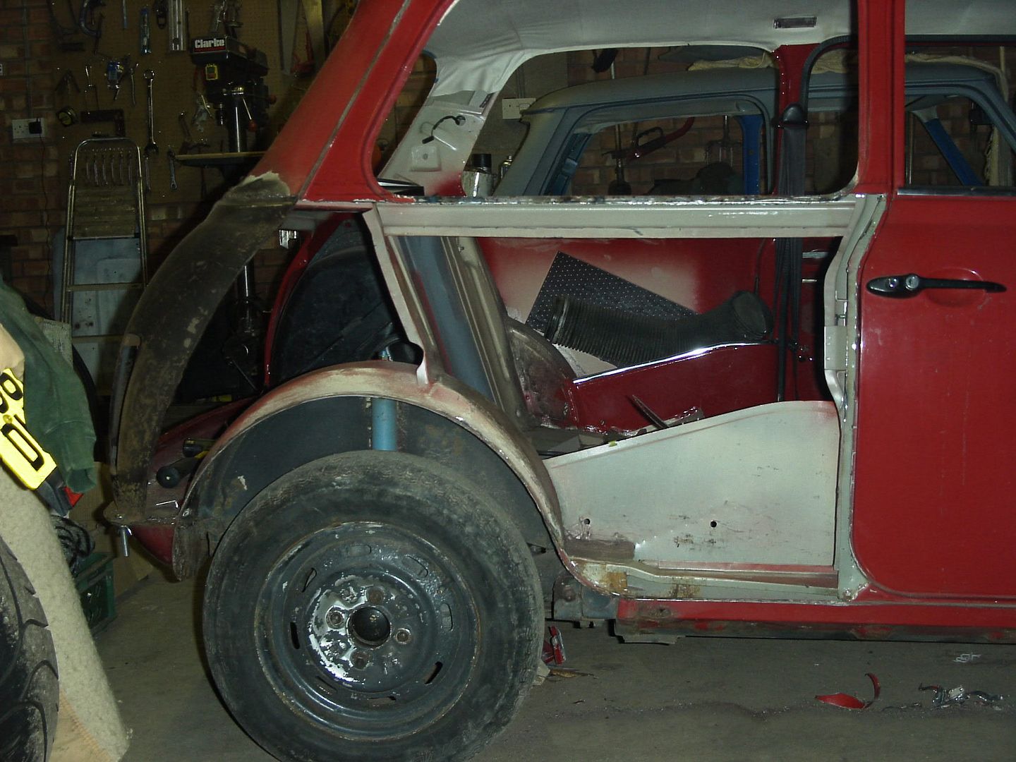

Well, When my first mini was hit by a third party, I got the payout and could buy the mini from the insurance for around 300 quid IIRC. Naturally - I took this route - and I would reccomend you do the same.

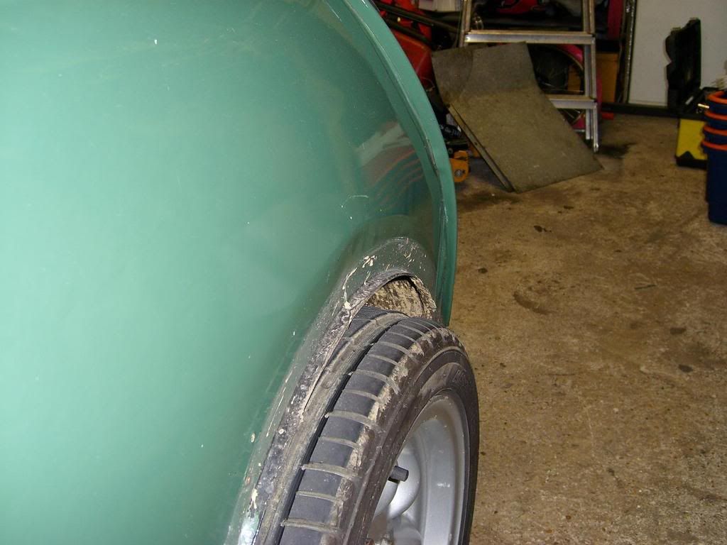

As regards your damage, it can be pulled a little - I'm sure the floor is recoverable - but I'm not seeing why/how the rear quarter got rippled at the very bottom?
Heritage rear 1/4 and heritage rear panel (do thyey do a half panel?) and a bootlid could have this fixed. Although your mate works in a bodyshop - unless he owns it he can't catagorically say he CAN fix it - or can he? Maybe he can fix it for a Price - but I'd be wary - say the bodyshop shits down or he leaves before it is done?
All said - I'd take the insurance route, and map out your options from there.
Edited by turbodave16v on 14th Jul, 2008.
Its totaly up to you tbh, If you went down the insurance route then you have the right to take it where ever you want?

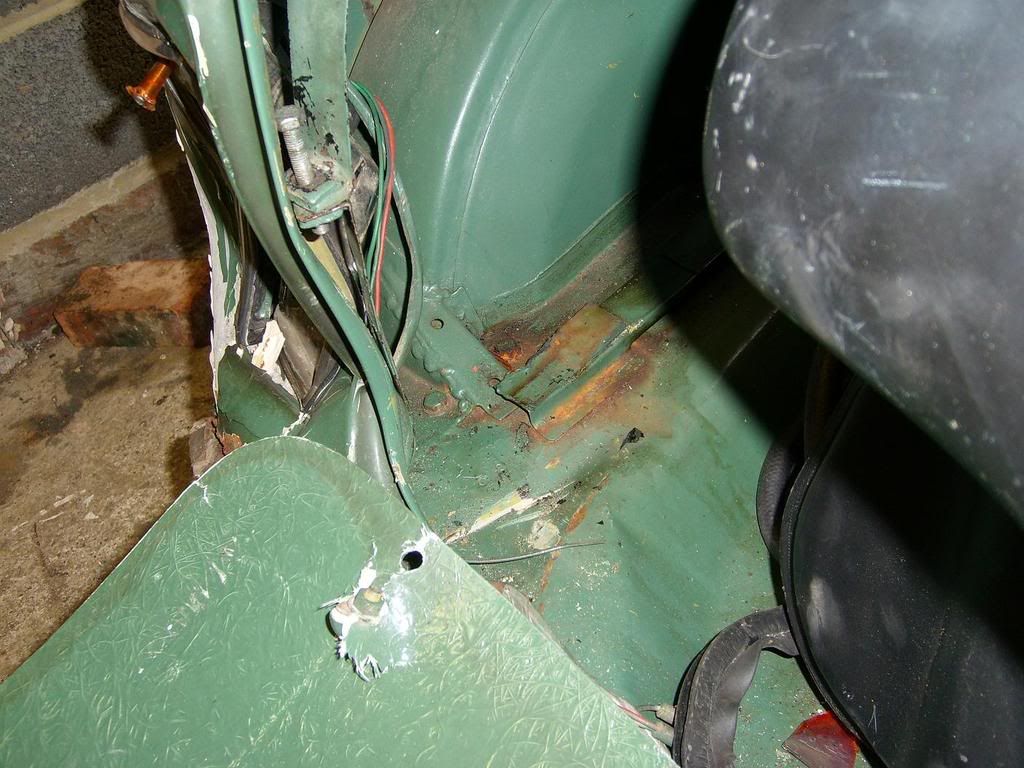

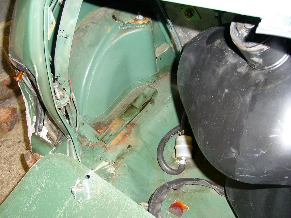

You could have it written off and agree to buy the car back off the insurance. The only prob i see is the rear end wants pulling but with the strengh in the rear seat it will prob just tear the boot floor.
End of the day it doesnt have to go to the scrapper mate regardless.

I would say that this will pull out if you get someone who knows what they are doing. The rear panel would need to be changed or a section of it
On 5th Sep, 2011 Vegard said:

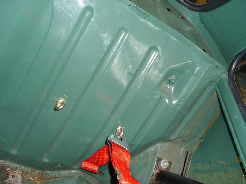

Shit didn't realise it had bent the back of the seat too!!!
I recon you should get Paul to get an evaluation from his work, if the work comes to stupid amounts you could pretty much say it would be written off, then decide what to do from there! *oh well*

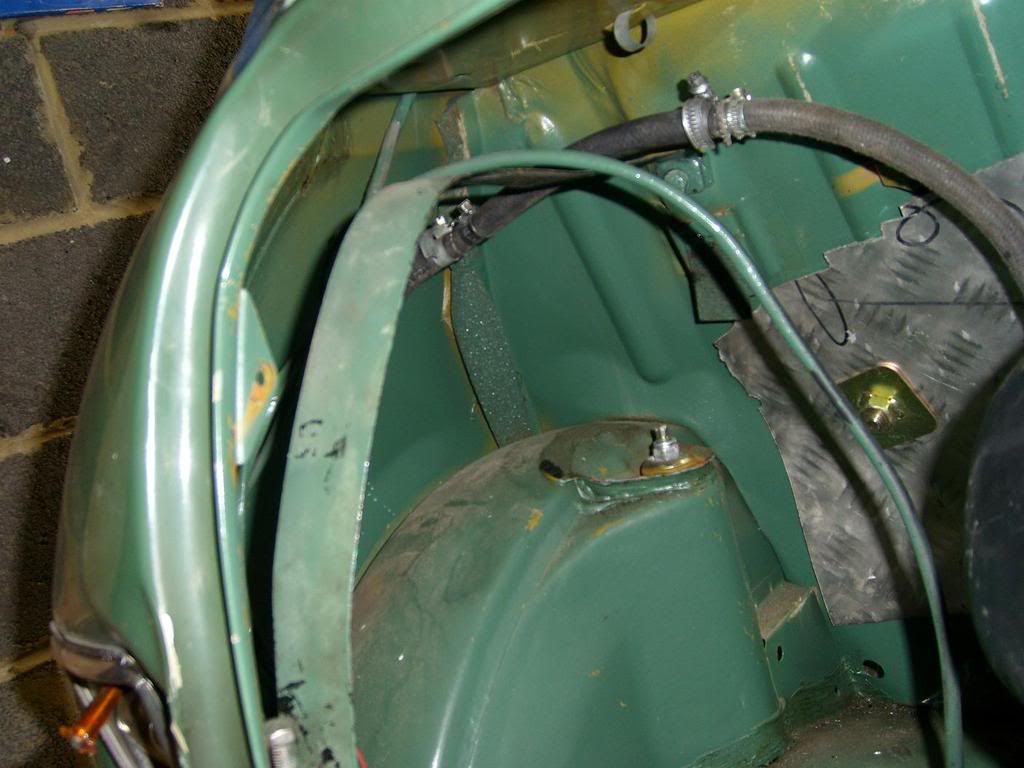

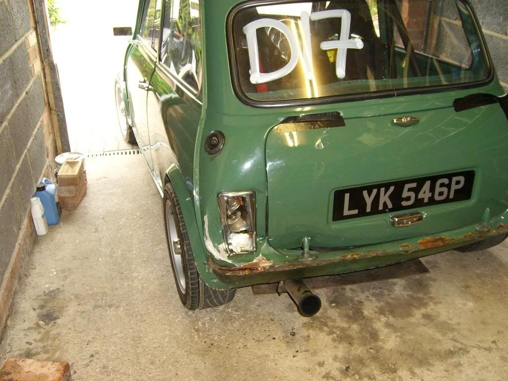

this is what we did to mine, the floor may hammer straight once everthing else is removed
The lower hinge panel needs replacing anyway, so perhaps part of the boot floor can be replaced too
Insurance will deffo write it off, but its certainly fixable. Id offer if I didnt have Gavins Speedster to fix.
Cut off the rear valance, cut out the damaged section of rear panel. Straighten the boot floor and rear seat bulkhead. For ease Id say put a new rear wing on as its rusty at the bottom anyway which has caused the crease in front of the wheel, then weld in a new rear panel section and valance. Quite an easy repair actually. I had a very similar thing on my 1964 on the other side. It was written off, I got £3500, bought it back for £100 and spent £400 fixing it.

just been out and measured wheel to wheel on each side and it doesnt seem out, or if it is it is only very very slight as cant see any difference when measured.
i have a feeling its pulled out at the bottom of the quarter panel as there was a nice chunk of filler in there by the looks of things so would have been a weak point perhaps.
There you go nic has even put pic's up.
No excuise to do it yourself

My main concern would be that rear wing crease, but if the wheelbase is unchanged, I would say have a go at repairing it.
For the rear wing to crease, the wheel arch must have moved forward a bit, but it most probably sprung back into place. The wing was most likely left creased because of the corossion and it being a flat panel.

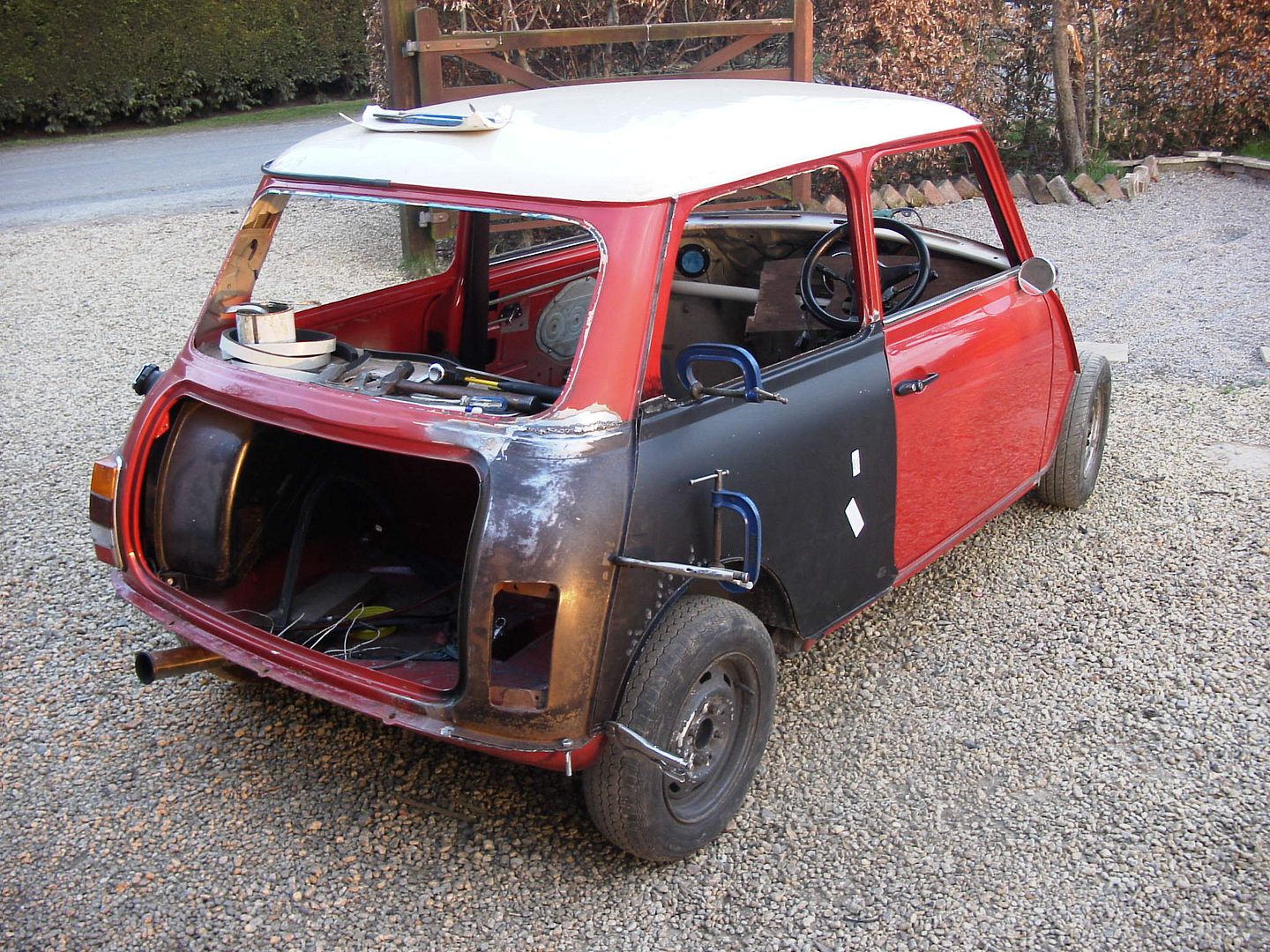

If you do decide to repair it I've a spot welder you could borrow to make a proper job reattaching the new panels.
