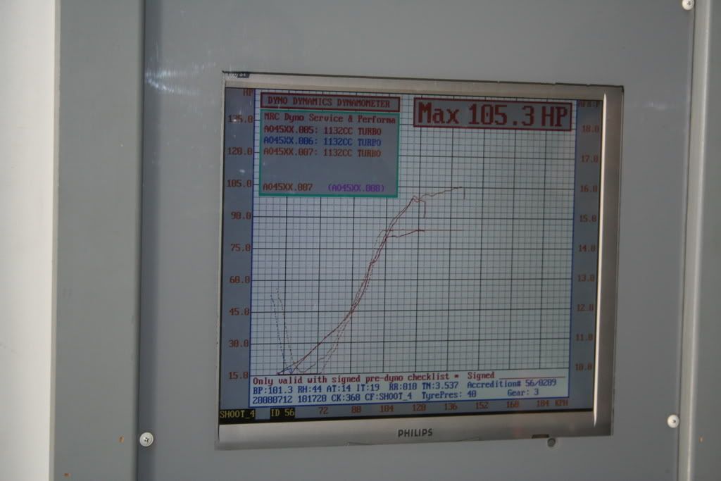

Yeah it helped my a/f by blocking it, but then thicker dashpot oil helped too... but in our dyno shootout the 1132 made 106hp at the treads (bananas for you lot :) ) but leaned out to 14.5 and the operator was worried

Mine is lean at full tilt, full boost, 6000 and 7000rpm. Ill scan the dyno dynamics sheet which shows the A/F on it.

Here is a pic from the shootout (I didnt take it, someone else did of one the runs I had. The dyno guy stopped the run and we went and spoke to him... keep going we said, dont worry about A/F now, if she break ill fix her later lol...
Lower lines are A/F (as per guage on the right its up to 14.5) HP is the one above...
Not happy with the run but I guess it made plenty of power for an 1132...
Anyhow, thats my A/F issue at the moment - Thats approx 7000rpm (I think its 6500) dunno
Peter
