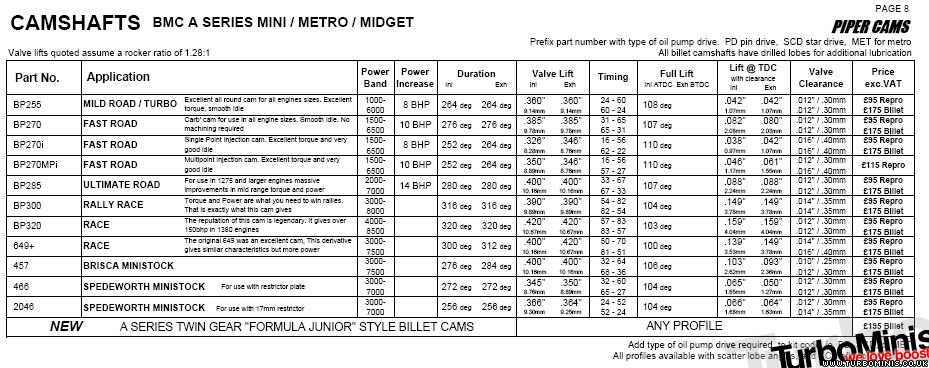

I've been using a fairly mild cam in my turbo and thus is fading a bit at top end. I still want to keep some drivability as i have now, but want to produce some more power? I've been told as well as gavin wakely (from a previous thread) that piper do a cam called a 475 or a 465? But i can't find it on the piper site
Do they mean the 466??? no power under 3000 rpm though? ideally i want something from 1500 to get the turbo moving? any ideas what this 465 cam is?

quite possible it may be the 265 duration cam similar to the kent 266
the power band you mentioned from 1500 helps

hmm, i am using a kent 266 in mine at the moment, reading a bit more into it, looking at the avon bar phase 3 turbo cam it produces power from 3000-8500, surely thats far to high for a turbo mini? it will just put all the power on at the same time the turbo is coming on boost surely? Am i right???????

The P3 is to radical to be honest, you'll lose all the bottom end the 266 gives.
