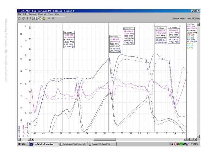

hope this is clear enough to read ,
this is a datalog of two runs at avon ,a 14.1 and 13.9,
you can see the boost wandering up and down as i adjust it ,and the 13s run has higher boost .the mixture is interesting ,its gone from around 12 to 1 on 7 psi , to 14 to 1 on 15 ish ,my su is definately not self compensating for boost .
another interesting thing is the leaner mixture for one run overall compared to the other run ,with no carb adjustment being made , i put this down to the bimetallic strip action on the main jet ,
cos the leaner run was after the richer run and involved a good 5 min wait in the lane waiting for the poxy lawn mower bikes .
i can put up the g force log if anyone wants it ,max g was around .63g's.
