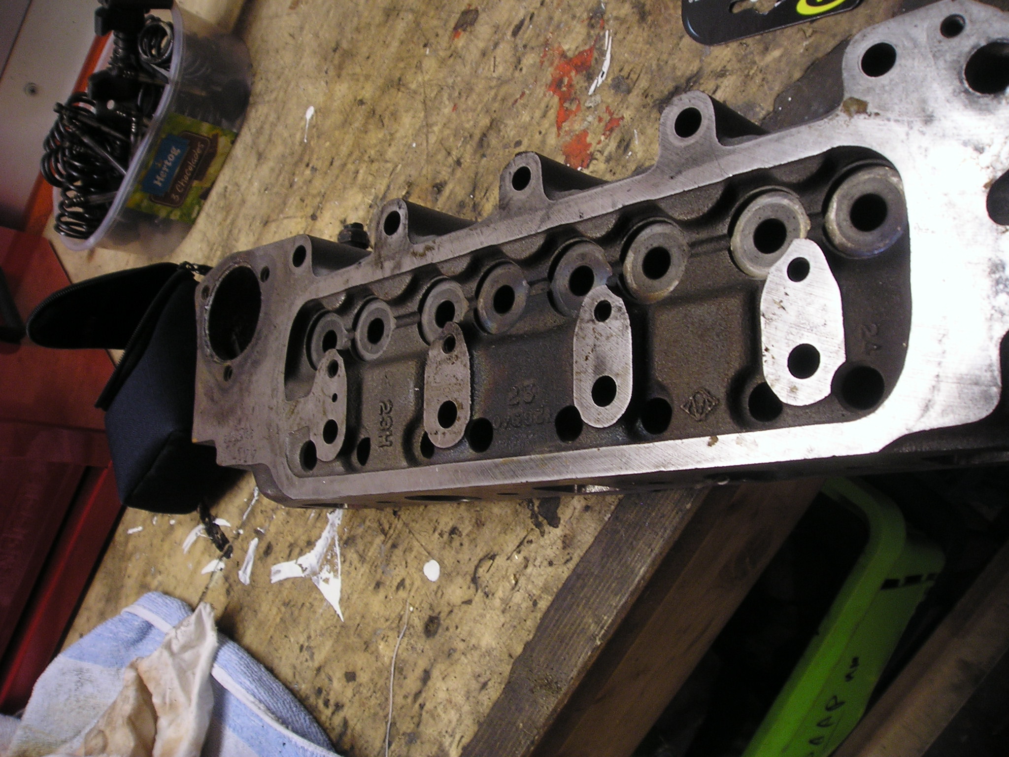

got my cilinderhead ported and before i could paint it i cleaned it in the washer at work.
But when it came out i saw something i did not like*oh well*
On top off the central exhaust port i noticed a differant colour. It must been extremely hot there, the lines are blue at the outside of the spot. And i see some lines inside off the head. I think it is most likely that it is start cracking over the and that's why the hot spot is over there, so the head it scrap. But maybe there is a other explanation for this:$ So how can i make sure what i got*tongue*

ive seen this hapen before on a N/A 1275 as it had being run with no coolant for a substantial time did no other damage though we reused the head filled coolant and it was fine. (Not one of my cars LOL)

look carefully if there is no cracks between the valve seats and none where the springs sit your fine . use a magnifieng glass
to be 100% you could have it crack tested

nothing strange to see between the valve seats, and were the valves sit.
So i guess i can fitt the guides etc...:)

Worth checking to see if the gasket face is nice & flat too.

either been run with out coolant or the ign has been to retarded in use or both. but get it crack tested and deck planed but should be fine

gasket face is checked and flat *Clapping*
But i could not explain the coloured spot.

The coloured spot looks like a valve guide tightened and caused a huge amount of heet to be transmitied into the guide hole caused friction between the guide and the valve, I have seen this on many race motors most times I have had to press the valve out of the guide with a hydraluic press.

if a tightened valve guide was the problem. I would suspect the heat spot more to one side and not so in the middle or is this wrong thinking *Confused*

Ok on closer inspection of your pic it looks like EGT was what caused the problam If you look at the pic the blueing is only around the exhaust valve and ports I would hazard a gues the Ignition timing was your problam or elve the rong type of Exhaust Valve guides if it was on a turbo.

it was not on a turbo engine but that is about to change*happy*
But EGT???????? i did have problems to get the ignition right off the engine it came off*tongue*
