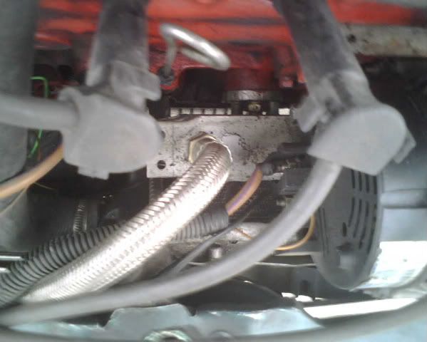

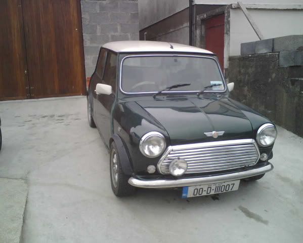

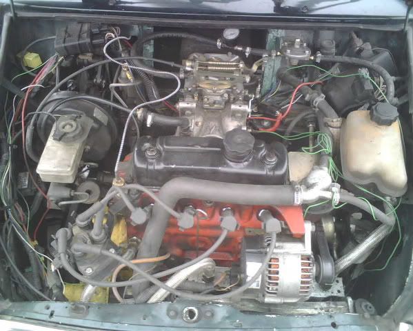

Well I taught I would give you all a look at my every day Mini
spec
It is a late 2000 Cooper shell in brooklands Pearlescent Green It was an MPI when I got it that changed almost immediately.
for a Mid 70s big bore block off set bored to 73.5mm
it has MED full crank N/C wedge bladed back drilled cross drilled balanced.
Lightened rods N/C and shot penned
Super light weight Flywheel.
AP race Plate.
Orange diaphragm.
custom back plate.
SW5 cam
ISKY Cam followers
Swifte Roller Rockers
Swifte 170 Double springs
REC 36.5 inlets and 32 Exhaust
Custom head
Weber 45
Longman 6inch manifold

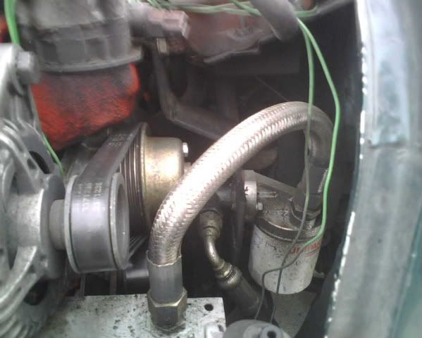

Maniflow Big bore LCB with full Maniflow double back box system
Minispares customized 5 speed box with Straight cut 1st and 2nd gear
and mini spares x pin diff
KAD 4 pot on 7.9 vented disk
GAZ adjustable shocks.

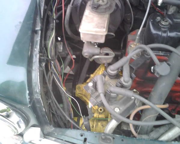

almost forgot it runs Mega Jolt with a KAD trigger wheel setup and
now V4
It made 109HP and 102 fp/lb at the flywheel at its last trip to the dyno.
after all that some pic
I love the way it drives with the SW5 it just pulls like a train from 1000 rpm.

Looks wicked, I bet that suprises people when you overtake. It looks nice and ordinary, but has a wicked engine.
is that tps or map?

Ya Im kinda into Sleepers All right is dirty messy and has a little power I get some funny looks when I start it all right frightened a lady out side the bank the other day who was standing with her back to the boot of a nice green mini when it bursted into life poor woman nearly droped a log.
Its was MAP but now TPS cant spot th sensor can you Lol thats cos its on the pedal.

i like the oil filter setup!!!!!
