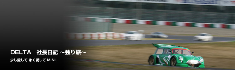

Hi does anyone know of any features on this Jap moster, aswell as any possible spec ?
I think its a kad motor , angled at 45 deg forward, trick in car ajustable roll bars, etc.
It was in miniworld ages ago i think.

Miniworld a couple of years ago.
1460, 210 hp, engine tilted forwards 40degrees.

has a titanium exaust manifold aswell.

210 BHP Kad 16v motor ? Im led to believe the best Kad have ever produced was 1460cc and 196 BHP. But any ideas what issue any articles are in as I've got far too many mags too go through *frown*
6965 Posts
it was a JK head, not KAD

Right its a 2005 copy but my front page has come away. Itll be either may or june
210BHP @ 9K RPM
{edit} carl beat me to it.
And its a Jack knight head. 16v

Found it Feruary 2005. Very impressive car and spec 8-)

can i ask what the theory behind tilting the engine was?
might'nt this not starve area's of oil?
Air resistance and straighter exh manifold.

Allow straighter drive shafts aswell as a better aerodynamic bonnet. They had to make a special oil pan and extra oil feed for the diff
