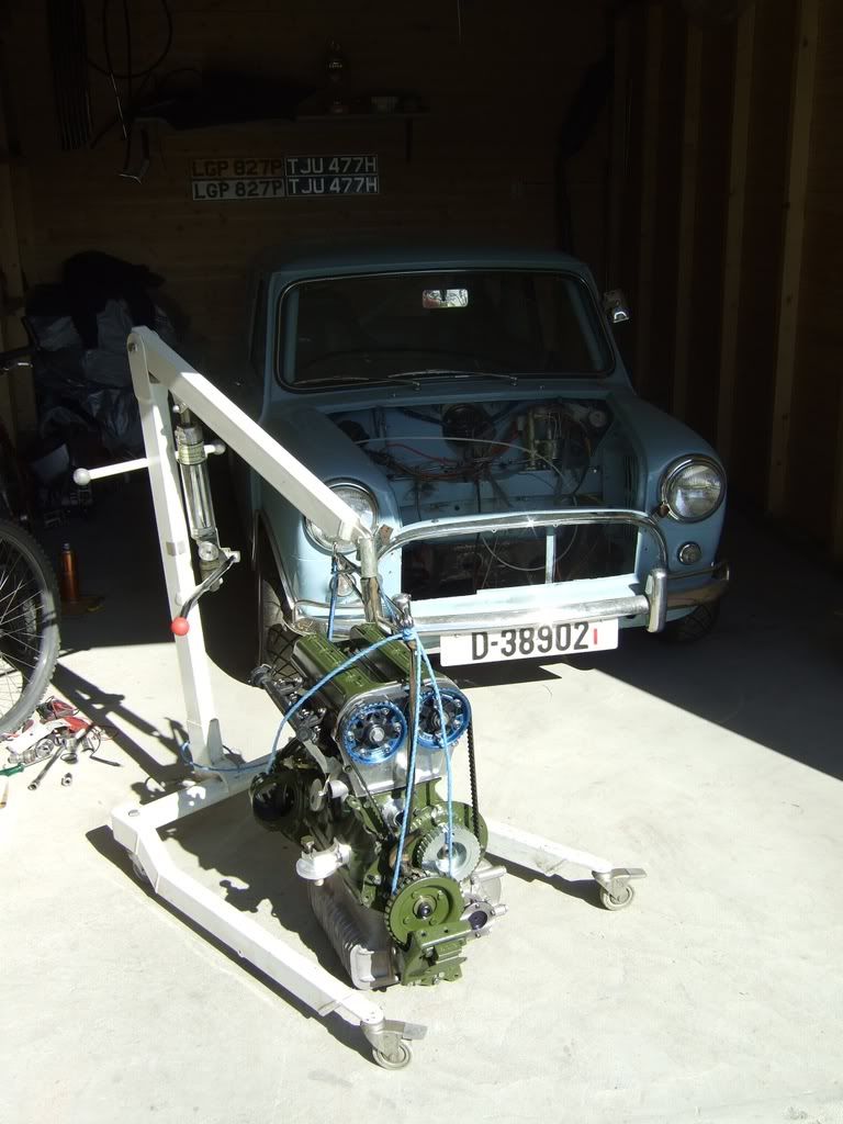

not quite finished yet, quite some tidying to do, but its not far off :)

Well done Andre, looks good.
Another nice example of the conversion.
Haha, finally the secret is revealed! Lol
Good work, as always mate! :)

yes, at last! it has taken a while, but I have a rolling road appointment next friday now, so should be 100% very soon:)

Nice one. What spec is the engine?

Spec:
-1343 A series allegro/1275 GT block with a 4 bolt center main cap
-72.5 mm pistons
-Custom rods
-Miglia spec crank based on a metro A+ crank
-ported K100RS 4V drydecked head.
-reground cams from specialist components
-manifold from specialist components
-top conversion kit from specialist components
-mix of old minispares parts and specialist components on the bottom conversion.
-Swiftune dog box with a race LSD and SC drops.
-4 mpi mini injectors
-modified K100RS TB's
-programable VEMS ECU controlling it.
All in a 1963 mk1 :)

back from the rollers! got 133 at the wheels, so about 155 at the flywheel then! Very pleased! Major thanks to Sprocket for helping out! And also to JohnK for answering all my e-mails in the beginning, and for selling me the parts!

yes they are quite aggressive:) They come in with a bang at about 4500, and go on until 8500, max power at 7900 rpm and max torque at 6600 or there abouts. The graphs are only on the paper at the moment. I have a quite large dip at 4250 that must be due to a tuned length problem with my spesific setup. both the torque and hp fall quite badly here, but comes back on again about 90 rpm later so no issue. We could not get it away even with several hours spent on it on the rollers.

not many:) It didnt have the torque to pull the dynoboxes (the type you fit to the drive flanges) around in fourth at low rpm, so we had to recalibrate and do the pulls in second. Think it was 14 hp or something:) This could have been bettered slightlywith proper tuning down there, but the dyno made that a bit difficult. New software for it on its way, and I will spend a full day there in the winter to map on E85 aswell.
