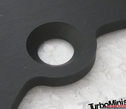

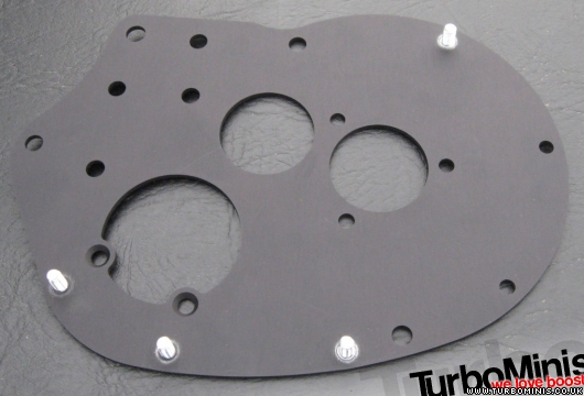

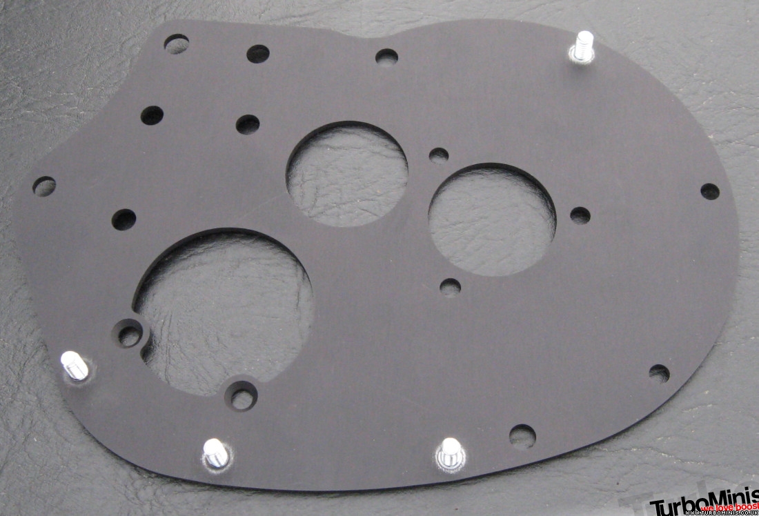

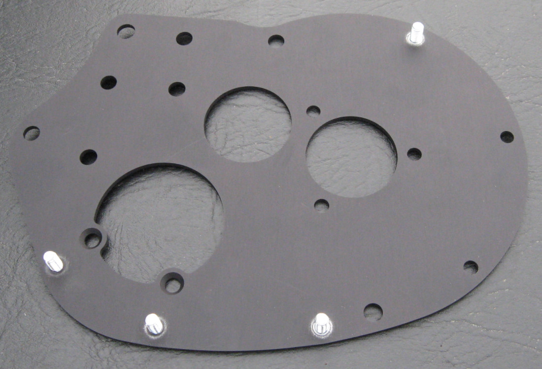

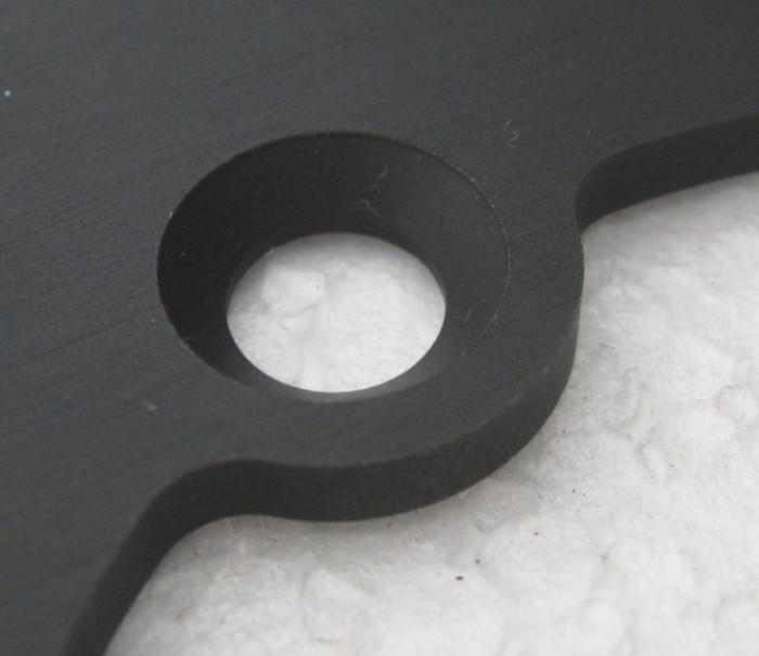

Home > Show Us Yours! > Latest Plates. Very happy with them personally. :)
Same shape as the old ones, but the profile in now CNC machined with a cutting tool, rather than water-jet cut. The 82-degree countersink is also CNC'd (repeatably perfect) and the whole thing anodised black.
If you don't like black, a different colour is a rattle-can away LOL.
Seriously - at this time I didn't see that having a stock of the usual colours (black, blue, red, silver) as being justifyable. Maybe I will if enough folks dislike black - comments would be welcome.
I do need to figure out how to optimise the installation of the studs to avoid distressing the anodising. I've got a few work-arounds that I'll try out.

Sensual.
How much?
Warning:Stig in Training
a good product just got better!
And who was the inventor of the counter sinks? A+ my ass! LOL
I'm not sure who invented countersinks.
It was you who pushed me into doing the 82-degree countersinking for 100% of the last batch however... :)

Looks good, what size are the bolts used on the countersunk holes as i need to get some screw type ones. 5/16th's?
screw type ones?
They are 1/4" UNF to match the threads in the main cap.
