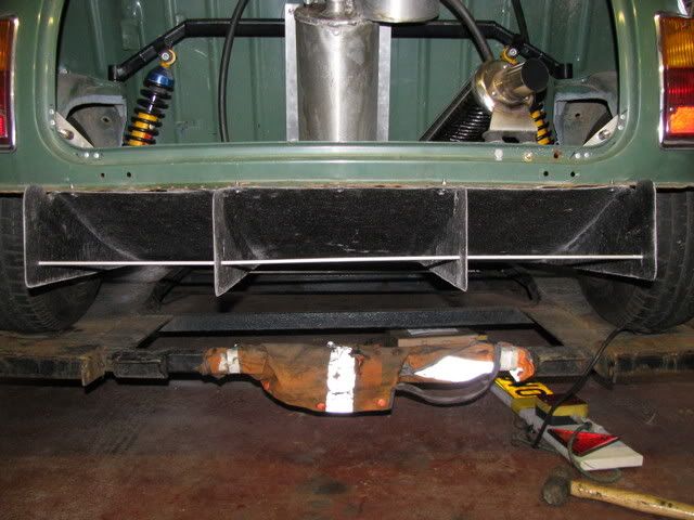

A mallet?
You stupid boy Pike.
Look like you've lost the rear valance, how careless of you Tom.
looks great mate, nice to see it with the carbon ex pipe. *wink*
different exhast too, or has that been there for a bit
Do keep up Robert, that has been gone for ages LOL!
The extra rear silencer is the "track day" spec exhaust for noise testing purposes, still on from Cadwell the other day, I just haven't removed it yet.

that rear suspension setup is very Imp like, (except it has no drive shafts) similar geometry though, more camber (in relation to the body) with roll.
Damn.. I was hoping it was paint...

That looks top work tom.
Have you tried it with that rear diffuser yet?
It should give you that much more stability at higher speeds.

More camber with roll? Are you sure about that LOL!
Surely it depends on where the two bushes are on each wishbone relative to a simple horizontal line straight across the body (ie, like standard Mini trailing arms, straight and horizontal).
Move the inner bush backwards or downwards relative to the outer one (like most modern cars which have trailing rear wishbone suspension do) and you get increasing (negative) camber with roll.
The Imp was a very early example of this.
What he said^^^
Although now I look again the pivots might not be at an angle like i thought.
heres an imp semi trailing arm.
is that one of carls difusers?
is that exhaust now quiet enough for track days?
Both the rosejoints are mounted to the heelboard, so it is a pure trailing arm, no camber change.

On 9th Aug, 2008 mini13 said:
What he said^^^
The Imp trailing arm bushes are at an angle to the centreline left to right (as per your photo), but probably not vertically (from memory) but that left to right bit of the design design certainly provides negative camber with roll.
Mind you, it's a few years since I drove my Imps around Mayland !!!
As Tom says though, if the rose joints on DON are parallel on the healboard, no roll induced camber changes.

Hmmm, are you sure that hot exhaust is a good idea near to the fuel tank Tom?
Other than that, rear diffuser looks ace :)

Go on then, now you've dug out the old diffuser. Are they going to be made available for sale again to the general public.
Because that would work so well on my motor. and save me the job of making one.
