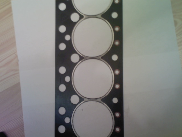

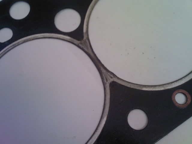

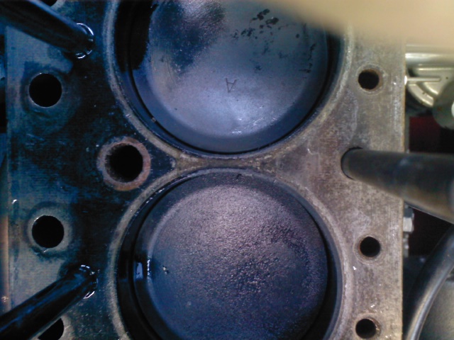

Right, had a spare hour this eve, and curiosity was getting the better of me so I whipped the head off the mini. There is a suspect dark patch between 2&3 which looks like it could be blown, but I cant see this being the cause of presurising the crankcase. No 3 piston has a build up of carbon on the crown, but all the others are clean, there is also carbo build up on the section of gasket which I suspect has failed. There are no other signs of failure on the gasket, which leaves me thinking it is rings.
I took the car out on sat, only on a 15mile round trip and by the time I got home was running like a bag of spanners. Im hoping when time allows the throw another gasket on and double check my torque wrench with a mates, but I dont hald out much hope.
Your thoghts? Sorry about the poor pics had to use my phone as couldn't get pics to upload on photobucket.

If your HG was causing excess crankcase pressure it would have to blow between a cylinder and the push rods and even then... I have blown a few between 2 and 3 and normally theres a bit missing in the fire rings and both cylinders have the same pressure.

Thats what I was hoping to see, that is is only sign of deteriation on the gasket. I had suspicions from the start that it was rings, only doin the gasket change to prove it.
Those of you that have had gaskets fail due to ill calibrated torque wrenches, what area of the gasket fails in this case?

whilst the head is off, bring all of the pistons level and poor a little bit of oil (bout 1") into the bores. Power steering fluid/automatic transmission fluid will do if you have any.
make sure they are all levelish and leave them for say 15mins. if they drop radically then rings arent looking too good.
its only a crude test but its a nice easy one to do whilst the head is off.

That HG looks ok to me :(
When my head wasn't torqued down properly, a large area of the gasket just fell to bits.
Any marks on the bores?
