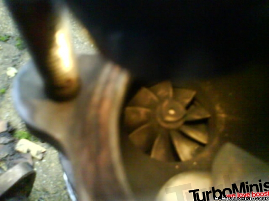

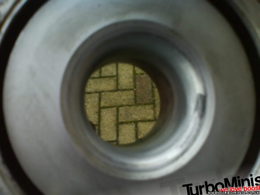

Ah nice one! Ive taken it out tonight and I think there are signs of the compressor wheel hitting the housing. There is only a slight burr on the blades, but I suppose the smallest amount will knock it out of balance?
Also noticed a crack running from the turbine wheel towards the outside of the exhaust housing. Not sure how salvageable it is?
The black mark is where I guess it first came into contact?
Im sure Ive read that this is quite common with turbos and not much of a problem, but its cracked on the right side.
